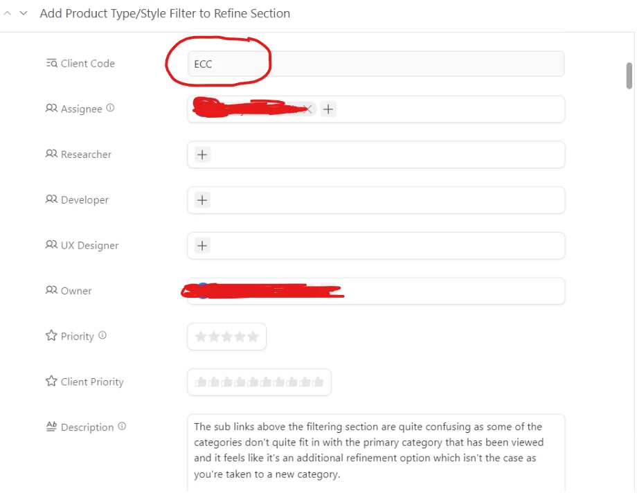

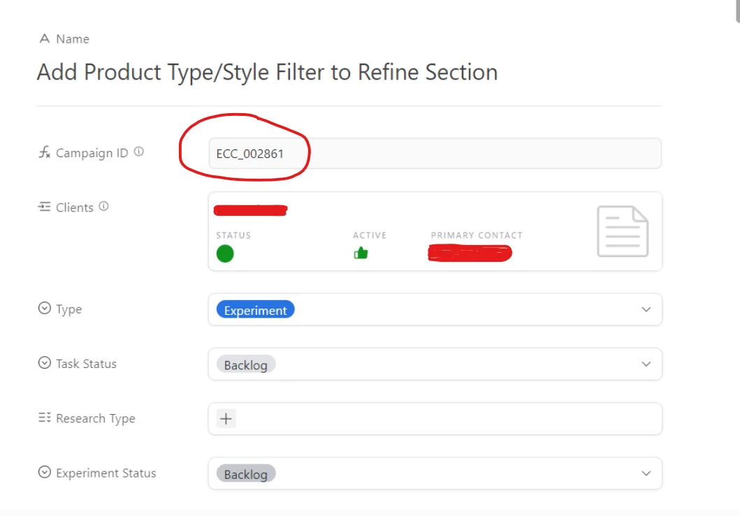

So you'll be able to see that in image 1 that's where a formula has been added to bring together the code (so in my case DE2), and then how it brings in the rest of the ID with the _002861 (in my case it'd be _000001)
In the second image I think this is the lookup field that allows the formula to pull in the prefix (DE2). I just don't understand where DE2 needs to be set up in order for me to pull DE2 in to a lookup field.
Ah, I don't think I have enough information to answer that question I'm afraid, this is more of a question of how your base is set up than anything else.  I'm assuming whatever table your "Client Code" lookup field is linked to has a field that indiciates "DE2" or something, or maybe "DE2" is already an option in your "Client Code" field
