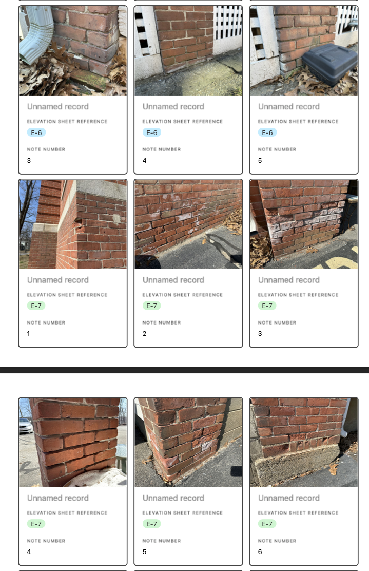

I have a base that is mostly photos, with reference numbers on each one. Because the photos are the "main event", I am trying to use gallery view to print and/or save as PDF.
However, I find that cards often break across pages, and sometimes leave the photos invisible. See example, attached.
Is there a way to make gallery view print so that cards do not break across 2 pages? Eg, if a card is to big to fit on the bottom of one page, I'd like the whole card to bump down and begin at the top of the next page...

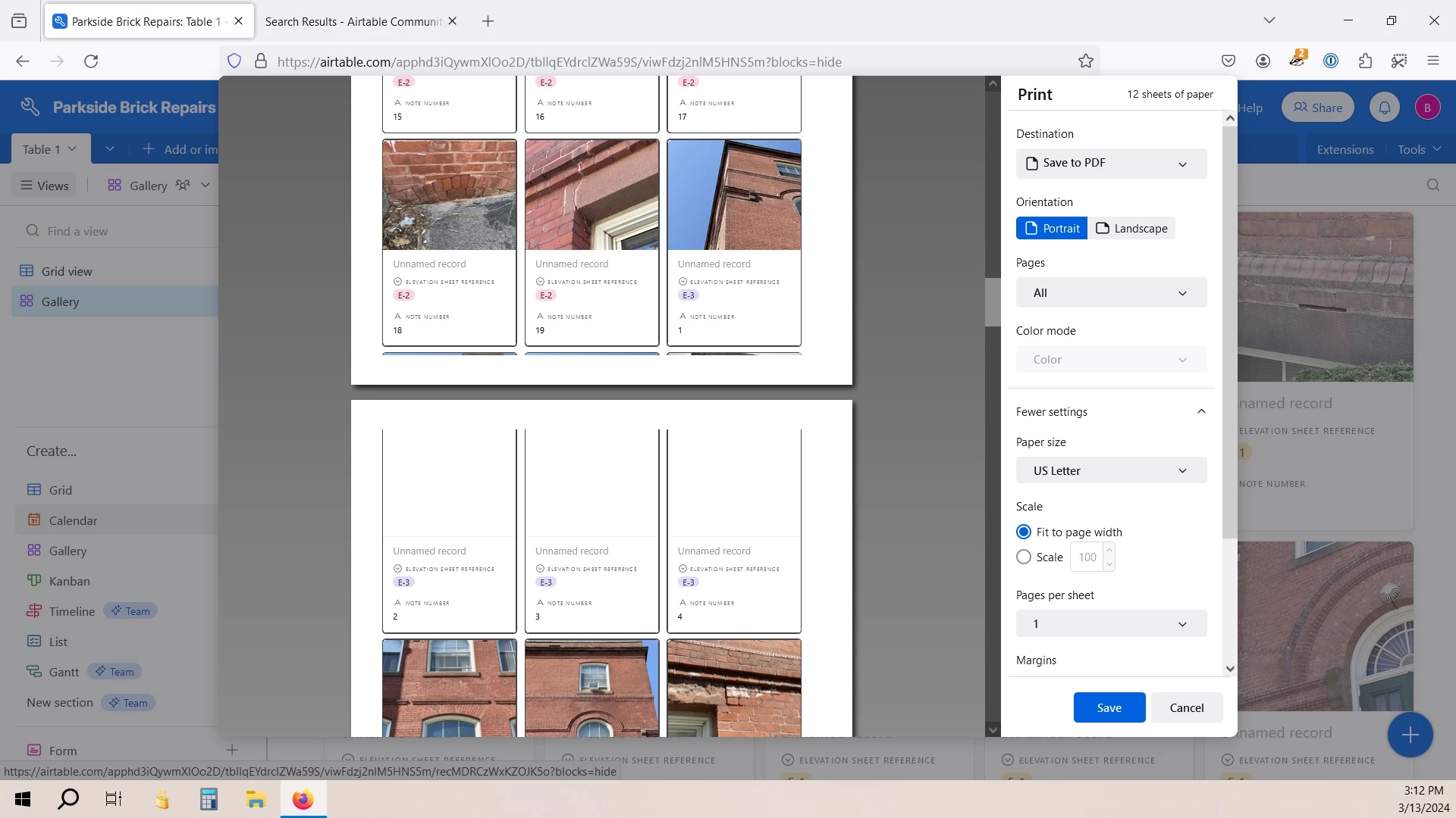

I don't think so I'm afraid.  Your cards appear to be all of the same height, so you could try just tweaking your print margins instead I think.  With a margin of 0.5 on the top and 0.3 at the bottom I managed to get this:
(Thank you very much for including a link to your base too; made trying to help with your problem a lot easier!)
  • March 14, 2024
Thanks Adam. This workaround solves it for me.
I hope airtable implements a more robust solution going forward... Can't have every user tweaking the margins by hand, every time they print!
