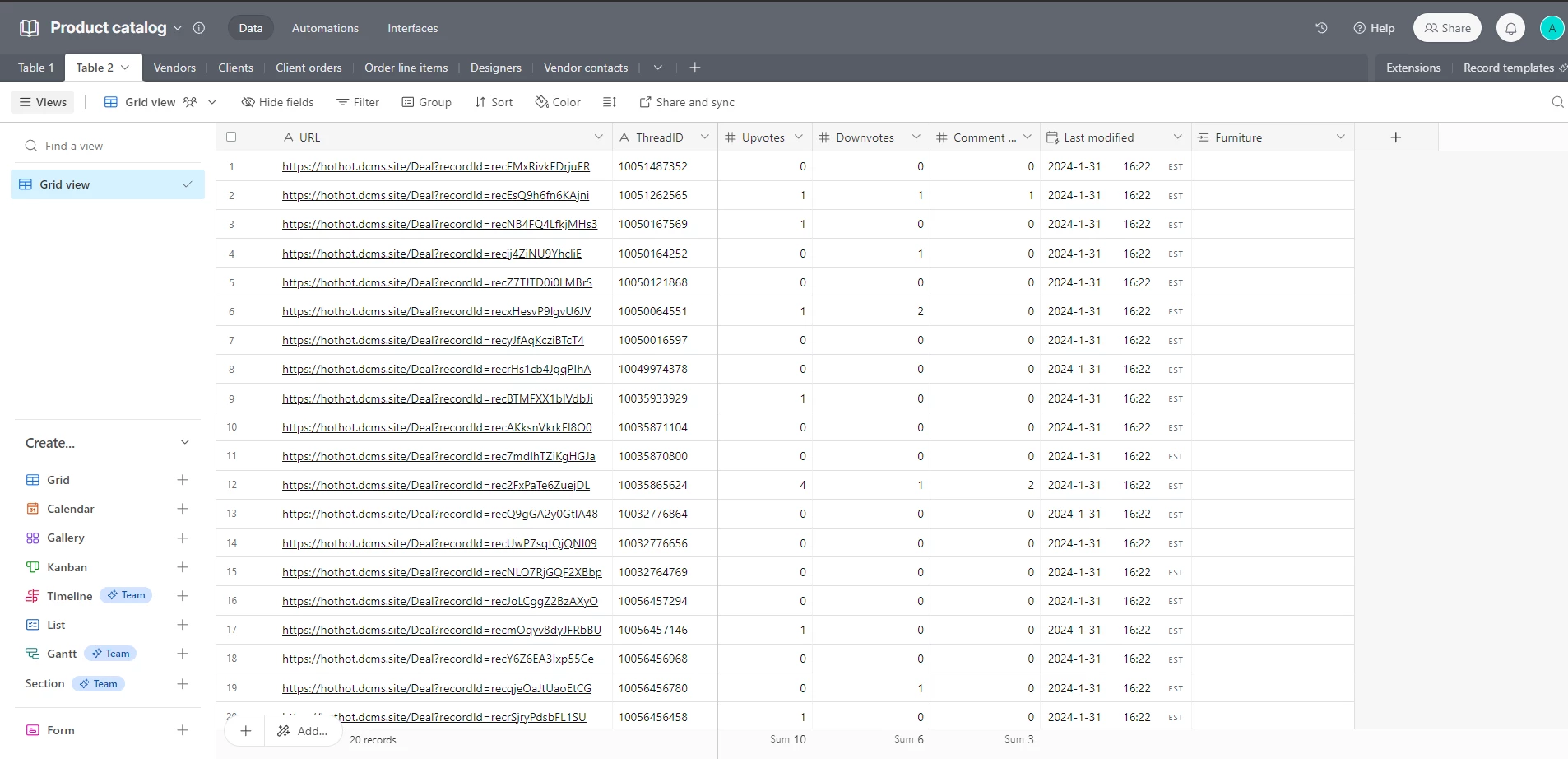

Hello Airtable Community,
I have 2 tables linked - the common column being "Deal Link" a.k.a "URL" (which is primary in Table 2).
I have a script that updates Table 2 via API.
The problem is, when updating via API, all the data linked in Table 1 from Table 2 disappears (even when record is unchanged). Is the link broken at this point ? How to remedy that ?
Thank you.

Hello,
Yes, it seems like breaking the link, sending empty value to the field 'Furniture'. This field is a link from Table2 to Table1, and it's a reflection of all links that you made in Table1 (even in 'one to many' or 'many to many' relations, the total number of links in Field 'Deal Link' of Table1 is the same as in Field 'Furniture' in Table2).
I think you need to review the script and fix it to don't touch link field. Or find other reason why 'Furniture' field is clean after API update.

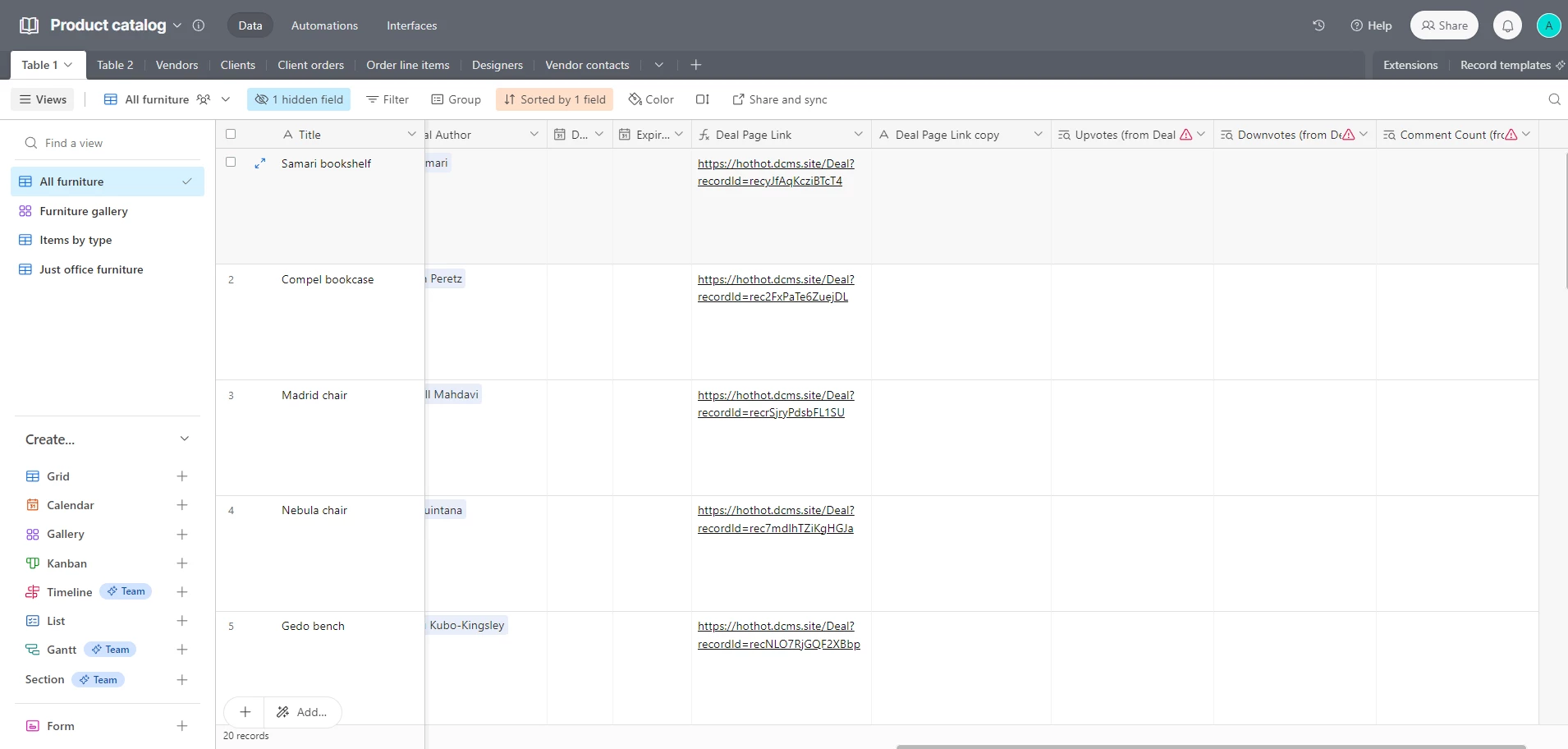

Thank you. In that case, is there any way to automate re-linking a field (from Table 1 ) to Table 2 every 1 minute for example ?
Expand any record in Table2, try with changed and unchanged and look at revision history
Just to ensure it is done by script.
But in other case I suspect, that you can see records without history. Text column 'Deal page link copy' looks like it was linked field, but then linked table was completely removed, and re-created again with all fields and new linked field. I don't know why and not sure. Extension/automation script can't remove table or field, but API scripting - maybe yes.
The problem is that lookups still rely on the field, which is no more linked.
The only thing I didn't get - where formula in Table1_post-update takes these values if links are empty
I'm not sure automation can help with it, because in-base scripting has very limited abilities to change base schema elements compared to API scripting.
