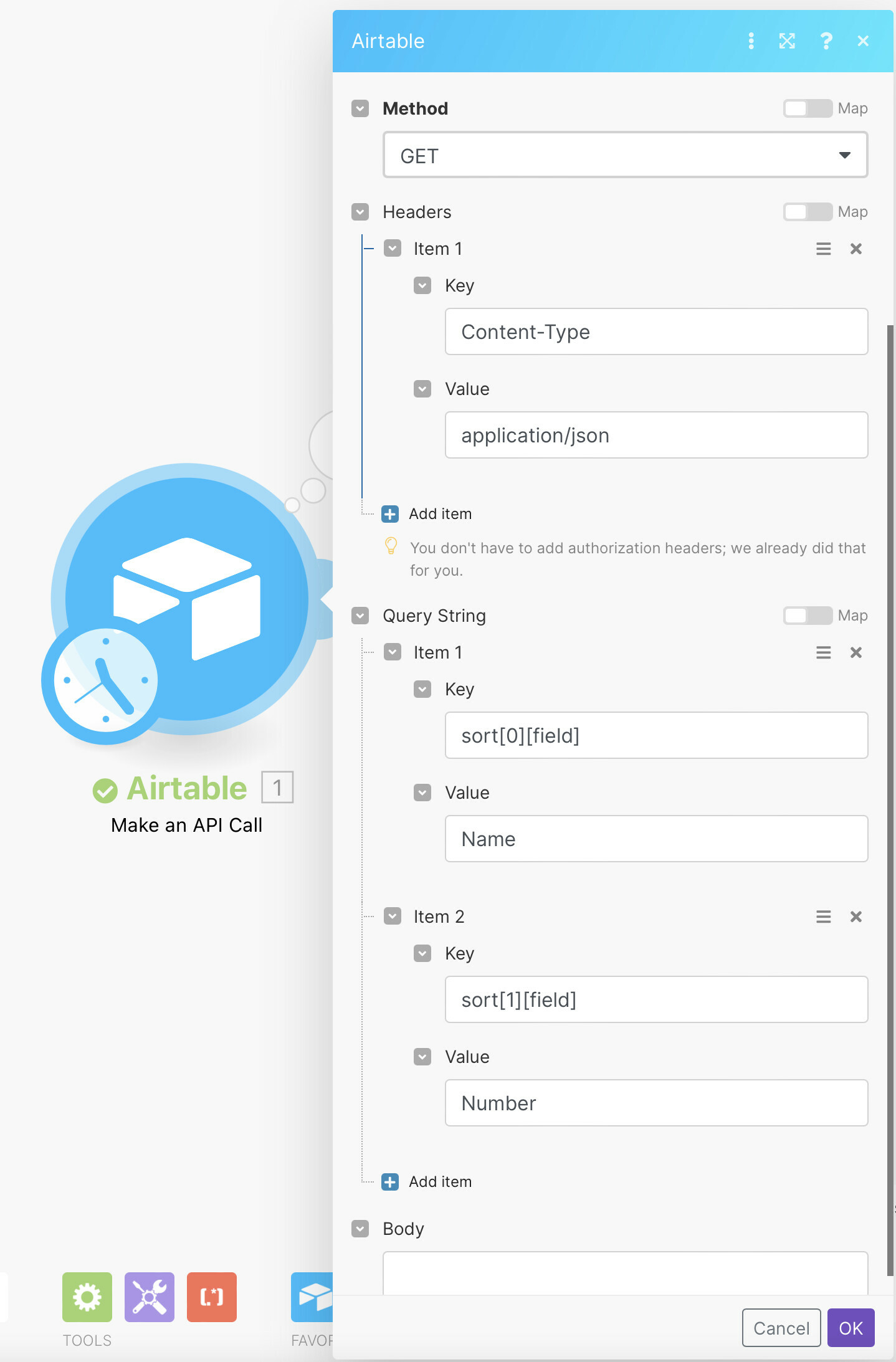

Hey there,
I am currently using the Airtable API by using Make (Integromat).
Since the sorting from the base won’t get passed to the output, you need to sort it inside the API call.
Now I want to sort my output by two parameters.
Unfortunately the sort[0] parameter gets overwritten by sort[1].
I would like to have the sort[0] prioritised, how could I do that?
Any input or suggestions would be highly appreciated.
Thanks in advance! :slightly_smiling_face:
That isn’t what the sort interface looks like in Integromat/Make. Where are you getting that screenshot from?

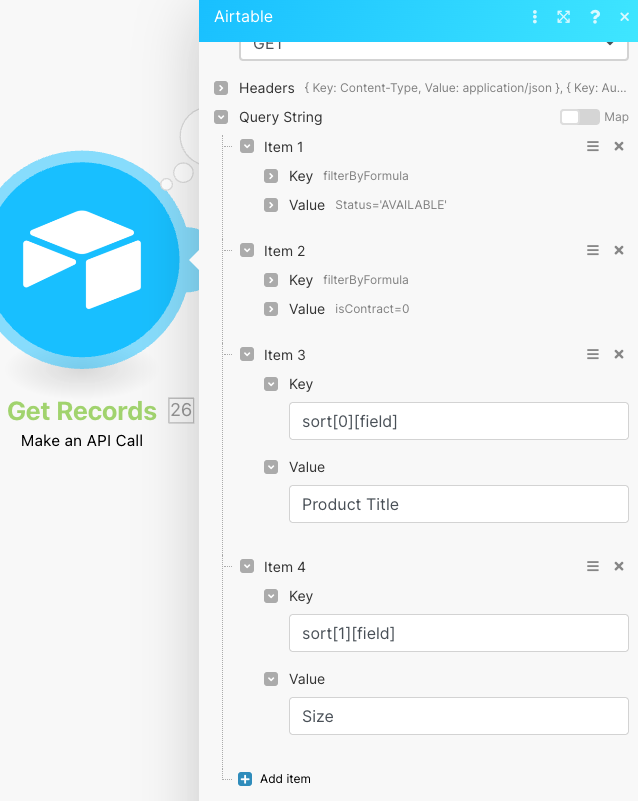

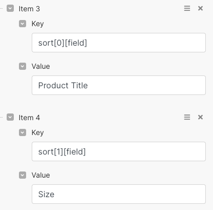

By the way, for what it’s worth, I just tested your code above, and it works fine for me! Check out my screenshot below from Make.com to make sure you have it correct on your end.
If it’s still not sorting correctly on your end, then you might have some problem with your data in Airtable, such as leading spaces in your fields that might be throwing off the sort.
