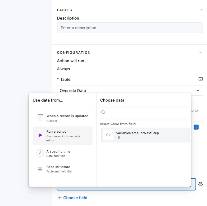

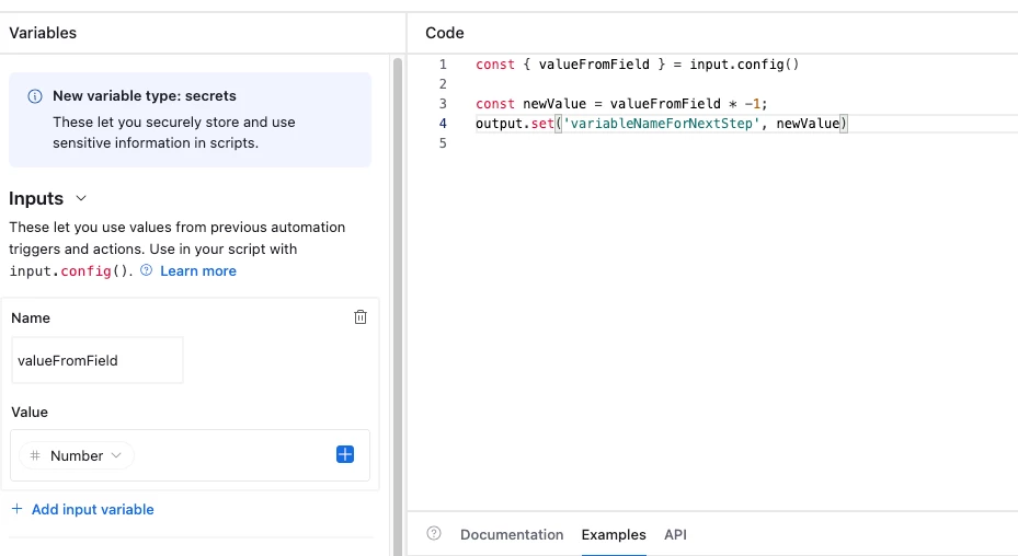

Here’s an example of how you can use `output.set` to get a value to the next step in your automation:
Then, you can use the output like so:
I hope this helps!

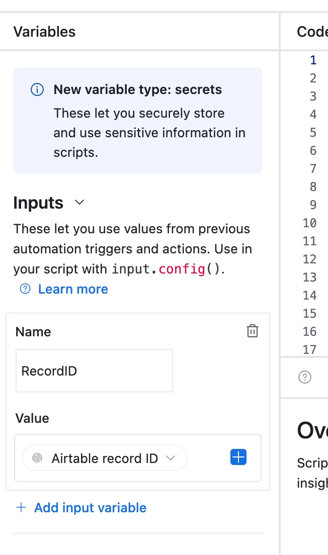

Hi ​@divingintux,
For the actual scripting part of it I would highly recommend you use Chatgpt with a detailed description of your needs and your schema (tables and fields, as well as field types).
For passing the specific record which should be used on the script, you’ll wan to have the record id set as an input on the left margin of your script -see exmaple below. You’ll set a Name and the actual Value which should be the record id (dinamically mapped). Ask chatchpt to get the value from the specific field out of the record id obtained through input.config().
  Hope this helps!

I do agree with Scott that in most cases you would want to use a Formula field. But since you do have the most context about your situation, I’ll assume it makes sense to do it with scripts in this case!
I hope this helps!

@BuildForAT This solution works. Thanks so much for the reply
