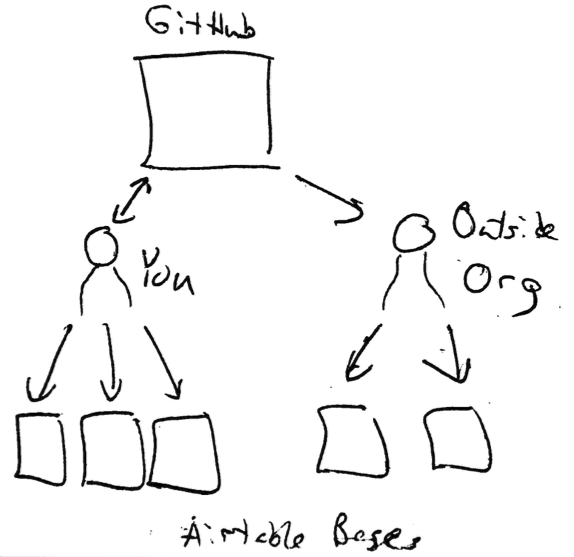

I may be missing both: a) you’re current/intended workflow; and b) features/limitations of how custom blocks work, but from my understanding, there isn’t really a “connection” with code in GitHub to begin with. Unless there is a CI/CD pipeline in play that executes block release on a code push, you/the user would need to pull changes locally and do block run or block release.
The way I see it, both of these scenarios are the same/similar. As long as the user outside the “organization” has access to the GitHub repo, they can git pull the latest changes and do the block run/block release dance on their local machines the same way you would within the organization.
The thinking would be like this (very rough) sketch
where both you and the outside organization can deploy the latest code, given both have access to the GitHub repo. And, if you had access to the block IDs, you could add them to the list of remotes and deploy from your end as well!
