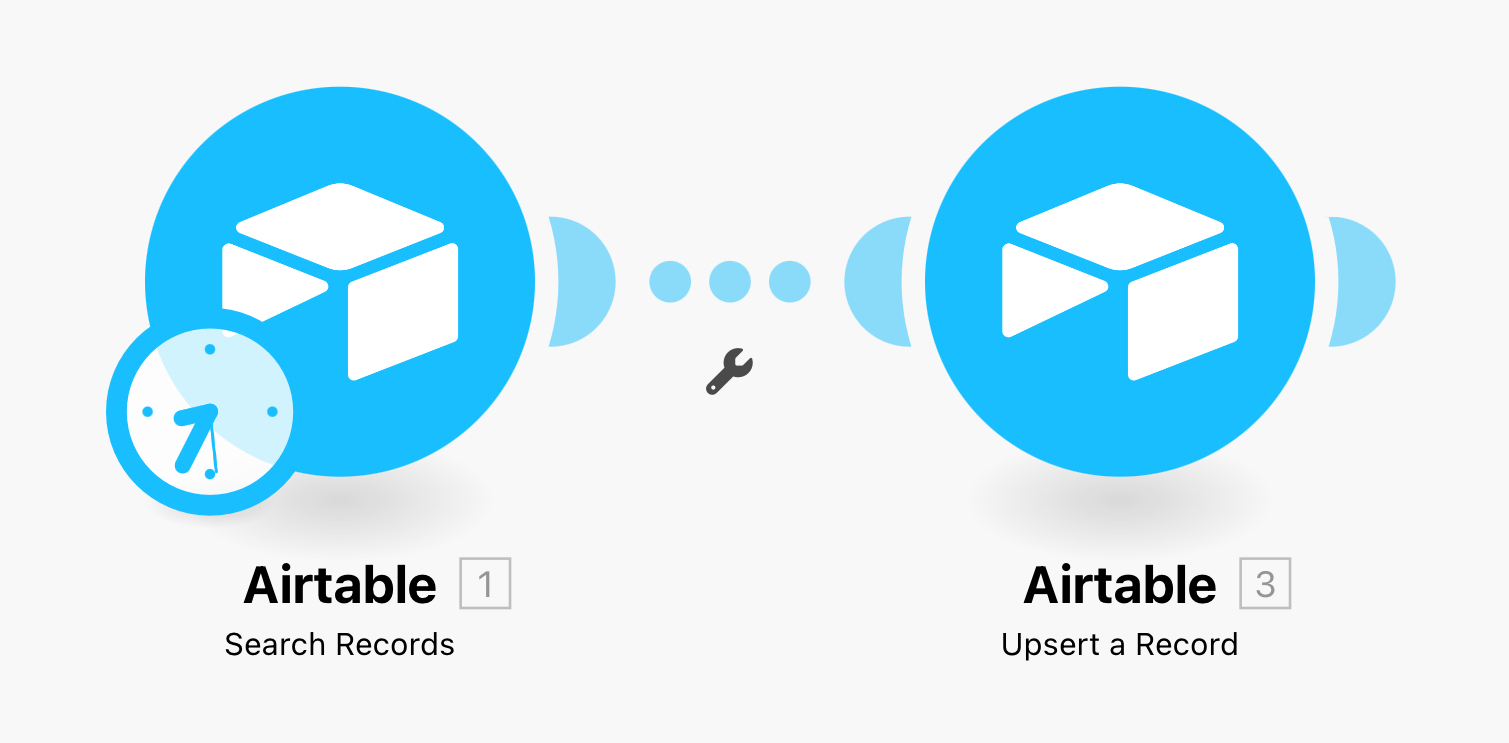

If you’re having difficulty coding, you can very easily do what you want in a no-code/low-code manner with Make’s Airtable automations & integrations.
In particular, you can easily use Make’s “search and upsert” functionality to do this. Check out the screenshot below.
