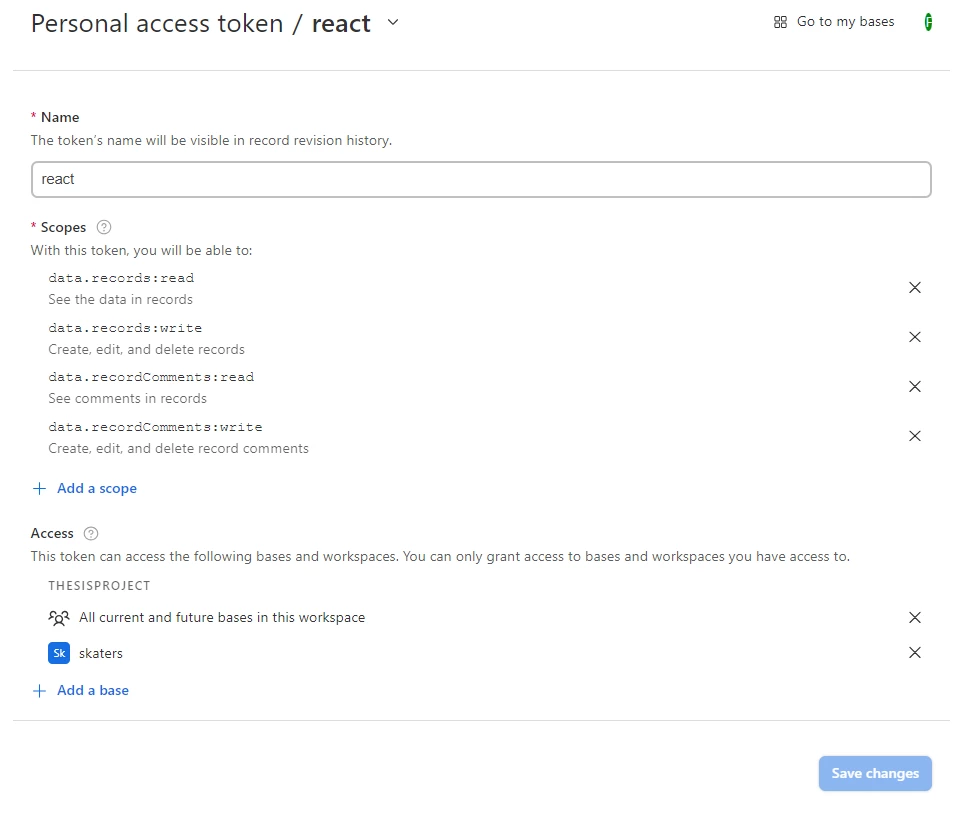

I've created a base table on Airtable.  Then from the developers/API key section, I created a token.  I've copied the Token ID from the personal access tokens section and pasted it directly .env file. I filled the information correctly.
Like this ;
AIRTABLE_API_KEY=pat*************
AIRTABLE_BASE=app8Knnd8Y8wQirZX
AIRTABLE_TABLE=products
Then I tested the connection. with this code block;

You can also see the scope and access section in the attachment.
I couldn't find the problem. If someone can help me, I gald.
