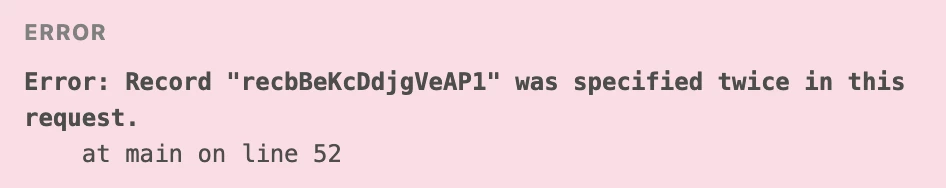

I’m working on a script to batch update linked fields and it seems to work for the most part but eventually throws this error:
I have checked for duplicates in the tables I’m working with but there are none. Any ideas what might be causing this? Here’s the script for reference:
