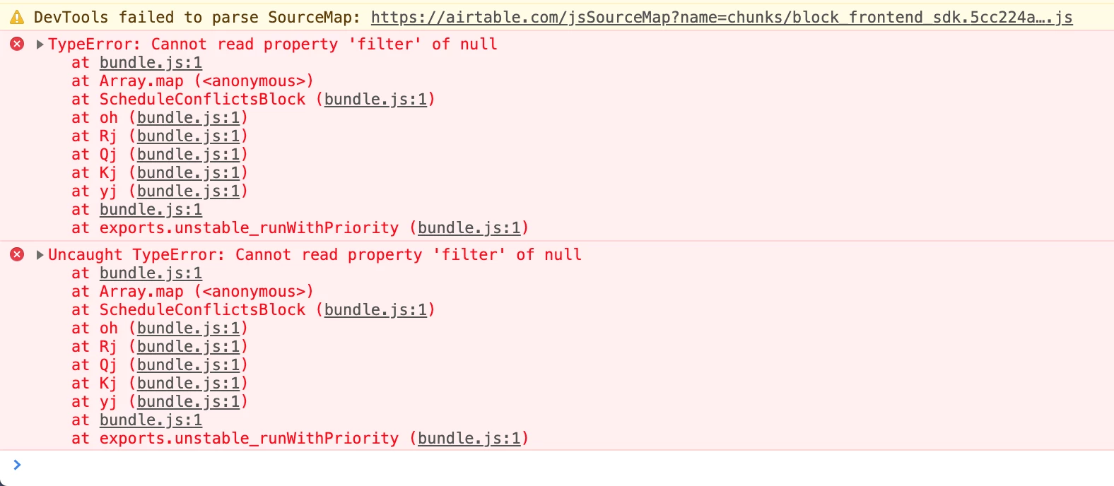

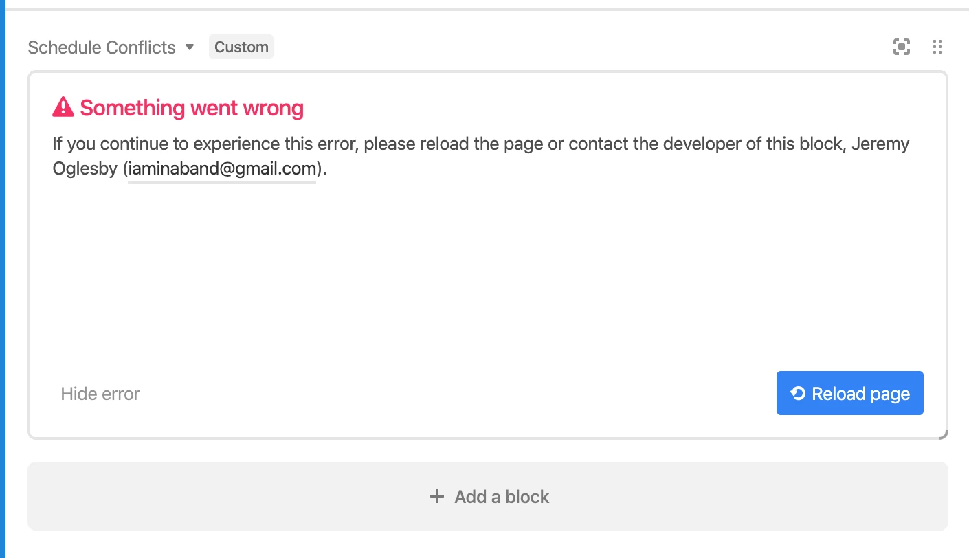

… however, my released block will not load, whereas I had no issues in development/testing:

Thanks for sharing that! Your SDK and CLI versions look good.
The console error suggests your block’s code was uploaded successfully, but has a runtime error due to calling .filter on null instead of an array. Would you be able to share the code there?
One gotcha with releasing blocks: the block installation you see in development has different GlobalConfig to the released block installation you see in your base (so changes you make while testing don’t affect your released block installations). Not sure without seeing the code, but if you were relying on a certain value of globalConfig being an array, that would cause this error where it works in development but not in release.
I am using globalConfig to store a <ViewPickerSynced .. /> selection.
And I call .filter on the records queried from that view.
I’m guessing this means the block is trying to initialize with a null key in the globalConfig for my view, and so the records are never being queried?
I think I get the problem, but I’m not sure I see how to fix it. Do I need to guard against null in the query, prior to filtering (as in, provide an empty array instead of null)?
Thanks for sharing the code!
Yes, this sounds correct - globalConfig returns undefined for a key with no value, getViewByIdIfExists(undefined) returns null, then useRecords(null) returns null.
Yup. The pattern our examples follow is: check that the models the block relies on exist and only render the “result” component if so. For example, in the simple chart example, the chart is only rendered if data exists - {data && ...}
You could also fix the problem locally by checking that appointments is not null when you try to filter it - const personAppointments = appointments ? appointments.filter(...) : [] . This is a quicker fix, but more brittle.
For ease of testing your fix - you can actually clear globalConfig in development mode. See the “GlobalConfig” tab below the development block installation.
Hope this helps you get your block working!

Thank you @Emma_Yeap! Super helpful!
I applied the quick fix and that got it up and running successfully. I’ll look into refactoring such that I can conditionally render the results. As my code is now, I don’t think it’s possible for me to do that. Thank you for helping me to realize that architectural mistake!
