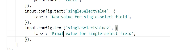

1st Step

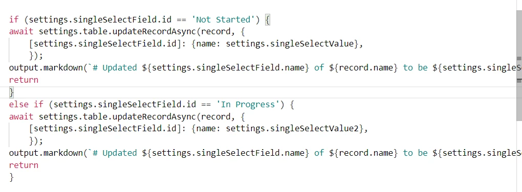

2nd Step
However, it’s not working. It’s not showing any error though. Do I put if statement in the wrong place?
  • September 17, 2021
Your code is not producing any errors because it is grammatically correct code. However, it is not working properly because the logic for your code is wrong.
I recommend using console.log() or output.inspect() to show the values of variables so that you can better understand what is going on. For example, try console.log(settings.singleselectField.id) and you will see that it is not the value that you expect.
