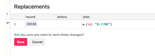

In my first foray into scripting in AirTable (AT), i searched around in scripting basics and a bunch in this fine topic and found the code i needed to try what i thought might work to copy the backup field, which is a Text field, and put it into the Lookup field. Before i hit Run, i put a Break into the code to stop after finding just one blank field to fix just in case. So then I hit Run button to test (i have a backup copy of my base), and got this display:
When i hit the Save button, i then got this message:
Error
L: Can’t set cell values: invalid cell value for field ‘art# FK to Inventory’.
Cell value has invalid format: .0.0.id must be an objectId.
Linked records field value must be an array of objects with property ‘id’ corresponding to linked record id.
at main on line 53

You have to get the actual record ID for the record which has the primary field value that matches your “source” field. For that you’d need to filter a query of the intended table for fieldValue = record.getCellValue(source) and then do let newValue = [{id: filtered[0].id}].
// Add this to outside your loop
let inventoryTable = base.getTable("I assume this table is called Inventory")
let inventoryQuery = await inventoryTable.selectRecordsAsync()
let inventoryRecords = inventoryQuery.records
// Add this to the loop
let filtered = inventoryRecords.filter(x => x.getCellValue("Primary field name") == record.getCellValue(source))

Hi Kamille,
Worked great. Using it in all sorts of scripts to fix this database. .filter() is clearly an important tool in scripting. Thanks for bootstrapping my toolbox!
