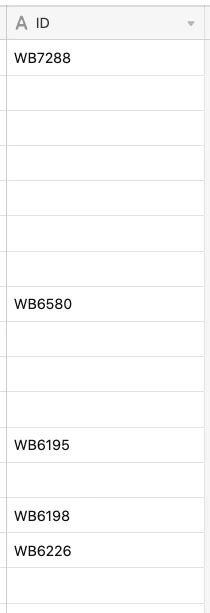

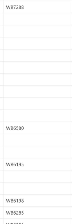

I am looking for a way to quickly “fill inn the blanks” with the value of the above cell. Something like “if cell is empty, then copy value of above cell”. (This is an issue after my weekly import to my base)
I know I can drag down to copy - but when there are many lines downwards, the speed is increasing to a level I am not in control of, and I risk scrolling too far and end up overwriting a cell.
So I am stuck with ctrl+C, ctrl+V, but that makes a lot of manual work, and is a source for errors. (I also have coworkers in the base, so I need it to be easy, quick and safe).
Any tips, tricks, formulas or scripts?

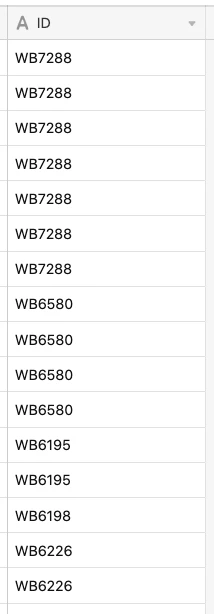

Before and after images:
WOW - That was quick!
It is exactly what was I was looking for. And it works like a dream; I can just sit back and follow the empty cells being filled.
Thank you <3
