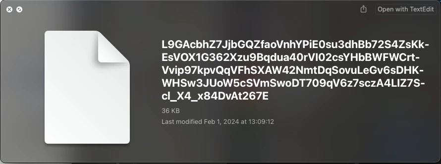

Im using Parser by Zapier to receive mails and create a record with certain infos mapped to my columns. One of which is the Mail Attachment to be placed in a File Column in Airtable. Somehow the file gets renamed on the process. In my example I send "invoice-60.pdf" to the zapier parser. It got added to the record as "9UngNgXzKLZ3jsMlQmQBOa95o1I5ENxS9LaFRxLNIfNkfLjB0I3ul64-P893QYjt62uhsUPyHBMe_P2i65Zv7-O3qjclkk4ACMI72H8AytGuav9QrcSMjQ1w8Sc1t4_UWDuEuGw6wGENXNjHf3XzQlMf2LLiwwxSveX6kdXYwBk"
Somehow the .pdf end got lost in the process.
I need to use an Airtable automation to send an email containing that file to a specific address when the status is changed. Due to the lack of .pdf ending the receiving system doesn't recognize the file and rejects it.
Bizarre enough, i can open it in Airtable and take a look at the filename, there is no .pdf at the end. When I download it though, the .pdf end is in the filename again... maybe it got added while downloading it?

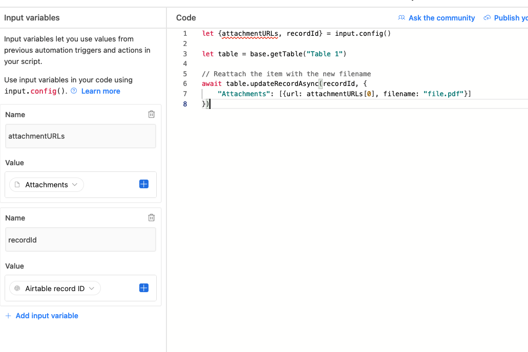

Assuming:
1. The file name doesn't matter and only the extension matters
2. You're on a Teams or above plan and have automations to spare
You could use a script action to handle this for you too I think, and here's something I threw together:
let {attachmentURLs, recordId} = input.config() let table = base.getTable("Table 1") // Reattach the item with the new filename await table.updateRecordAsync(recordId, { "Attachments": [{url: attachmentURLs[0], filename: "file.pdf"}] })
And it should look like this with the variables set up:
It basically just reuploads the file, and forces it to be a pdf

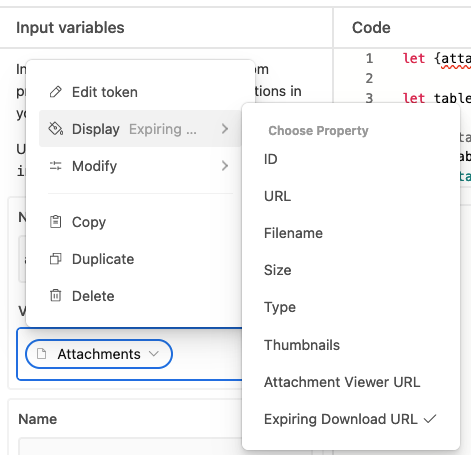

Do take note that when you're setting up the attachmentURL variable you need to set it to be the expiring download URL:
Wow thanks! That solution works like a charm. Only thing now is, that the script seems to be not fast enough to rename the file.
