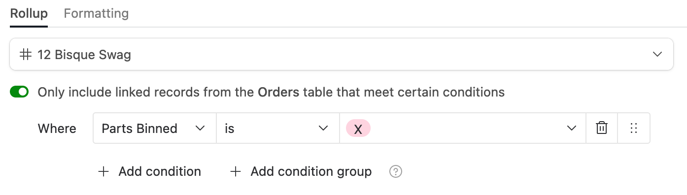

2. For each inventory item, create a single rollup field in "Inventory Synced" that will have a formula of "SUM(values)" and a conditional to only include Orders where "Parts Binned" is X
3. Finally, create the `Required Parts for Non-Binned & Non-Assigned Projects` field as a formula field with the following format, where you would have to add in the inventory item name followed by the rollup field:
