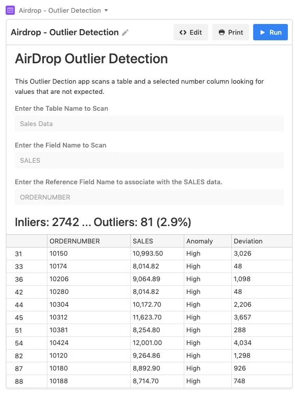

To that end, here’s a script block that uses the multiple interquartile methodology to find outliers. Once again, this is a pretty good use of a Script Block because doing this with formulas is likely impossible. Full source is provided … enjoy.

output.markdown('# AirDrop Outlier Detection');
// display app introduction
output.markdown('This Outlier Dection app scans a table and a selected number column looking for values that are not expected.');
// prompt for the table name
let sourceTblName = await input.textAsync('Enter the Table Name to Scan');
try {
  var sourceTable = base.getTable(sourceTblName);
} catch(e) {
  output.markdown("ERROR: @ " + e.stack + " :: " + e.message + " (22)");
  return(false);
// prompt for the number column name
let sourceColName = await input.textAsync('Enter the Field Name to Scan (IMPORTANT: Must be a Number Field!)');
// prompt for a reference column name
let sourceRefName = await input.textAsync('Enter the Reference Field Name to associate with the ' + sourceColName + ' data.');
// get the data set
try {
  var result = await sourceTable.selectRecordsAsync();
} catch(e) {
  output.markdown("ERROR: @ " + e.stack + " :: " + e.message + " (36)");
  return(false);
// iterate across all the records
var aData = [];
try {
  for (let record of result.records)
    if (record.getCellValue(sourceColName))
      aData.push([record.getCellValue(sourceRefName), record.getCellValue(sourceColName)]);
} catch(e) {
  output.markdown("ERROR: @ " + e.stack + " :: " + e.message + " (49)");
  return(false);
// test for outliers
var aAnomalies = findAnomalies2D(aData, 1, 1);
var minValue   = aAnomalies[0];
var maxValue   = aAnomalies[1];
var aResults   = aAnomalies[2];
// filter for the outliers
var oOutliers = [];
var count = 0;
for (var i = 0; i < aData.length; i++)
  if (aData[i][2] != "Inlier")
    oOutliers[i.toString()] = {};
    oOutliers[i.toString()][sourceRefName] = aData[i][0].toString();
    oOutliers[i.toString()][sourceColName] = aData[i][1].toFixed(2).replace(/(\d)(?=(\d\d\d)+(?!\d))/g, "$1,");
    oOutliers[i.toString()]["Anomaly"]     = aData[i][3].toString().replace("+", "High").replace("-", "Low").replace("x", "Normal");
    oOutliers[i.toString()]["Deviation"]   = (aData[i][3] == "+") ? (aData[i][1] - maxValue).toFixed(0).replace(/(\d)(?=(\d\d\d)+(?!\d))/g, "$1,") : (aData[i][1] - minValue).toFixed(0).replace(/(\d)(?=(\d\d\d)+(?!\d))/g, "$1,");
    count += 1;
output.markdown('## Inliers: ' + (aData.length - count).toString() + " ... Outliers: " + count.toString() + " (" + ((count / aData.length) * 100).toFixed(1).toString() + "%)");
// output.markdown(count.toString());
output.table(oOutliers);
