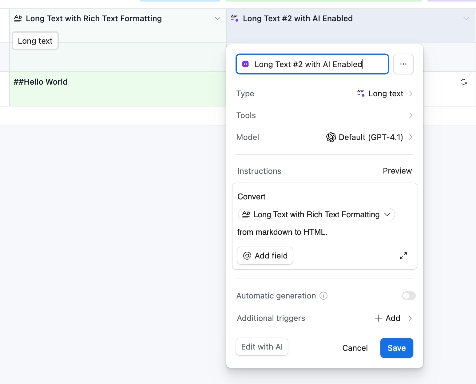

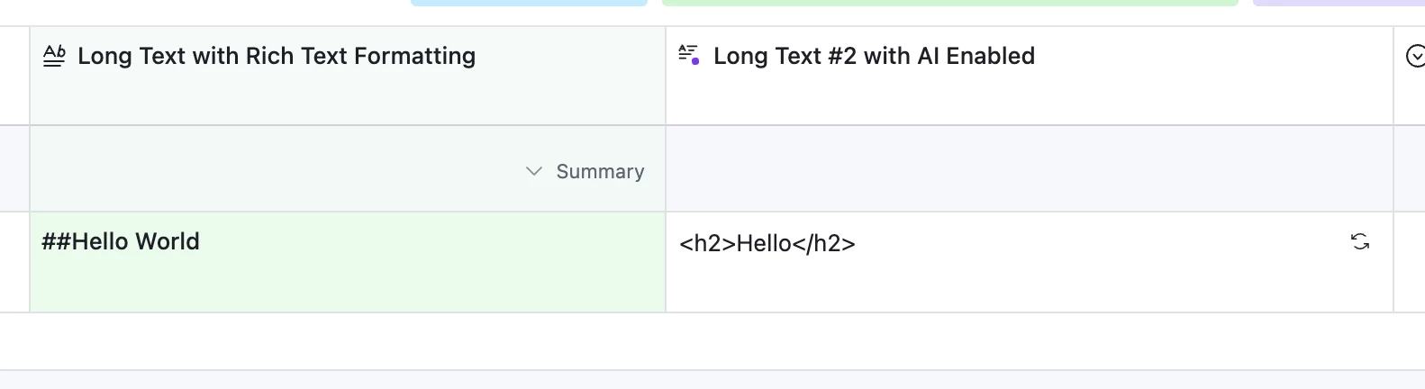

  • Aug 3, 2026 8:50 PM UTC
This is a little bit unintuitive to setup, but if you already have a rich text field (i.e. a long text field with rich text formatting enabled), then you can create ANOTHER long text field and convert it to an “AI” field, and tell the AI to convert the first rich text field from markdown to HTML.
Check out the 2 screenshots below.
You can also use AI in automations as well, but this is probably the more straightforward way.
