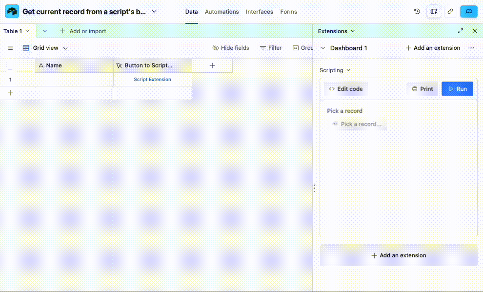

I’m new to airtable and I try to make a script triggered from a button field. I need to get the selected record linked to the button clicked but could not find how to achieve this.
I can’t believe there is no way to get the current record id from the script, what am I missing?
Thanks.
Not quite sure if I understand what you’re asking, so apologies if I’ve got it wrong!
On the data layer, we’d point the button at a Script Extension, and here’s an example script to get you going:
https://airtable.com/developers/scripting/api/input#config
https://airtable.com/developers/scripting/api/input#record-async
let tableId = cursor.activeTableId
let table = base.getTable(tableId)
let record = await input.recordAsync("Pick a record", table)
await table.updateRecordAsync(
record.id,
"Name": 'Clicked'

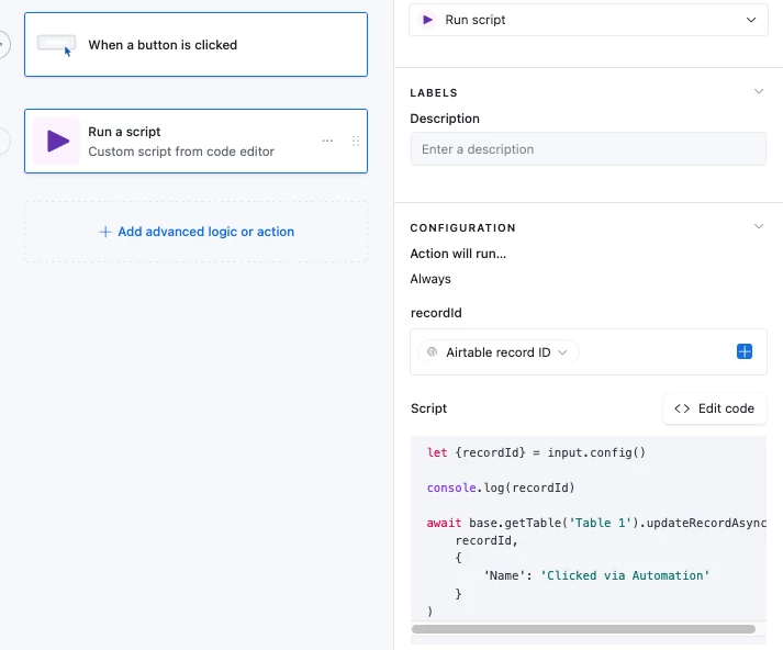

If we’re doing it via an automation via an Interface, then a button field wouldn’t be usable and we’d need to set the recordId as an input variable:
let {recordId} = input.config()
console.log(recordId)
await base.getTable('Table 1').updateRecordAsync(
recordId,
'Name': 'Clicked via Automation'

  • March 25, 2026
Thanks ​@TheTimeSavingCo , that’s exactly what I was looking for!
