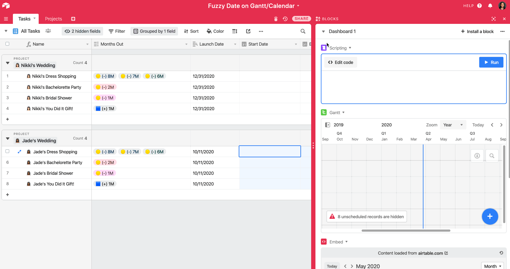

Sometimes I plan thing out way far is advance, like say 9 months out from a pretty important launch date - like my best friend’s wedding! (So excited for her :bride_with_veil:t5: , but I digress.) There are certain dates that I want to estimate, but as I get closer to the date want to visualize and edit further on Airtable’s Calendar View or Gantt Chart.
The Calendar View and Gantt Charts Block only accept date fields, or formula fields that calculate dates. However, I still want to retain the ability to move these dates around on the calendar/Gantt if something comes up. So, how do I do this?

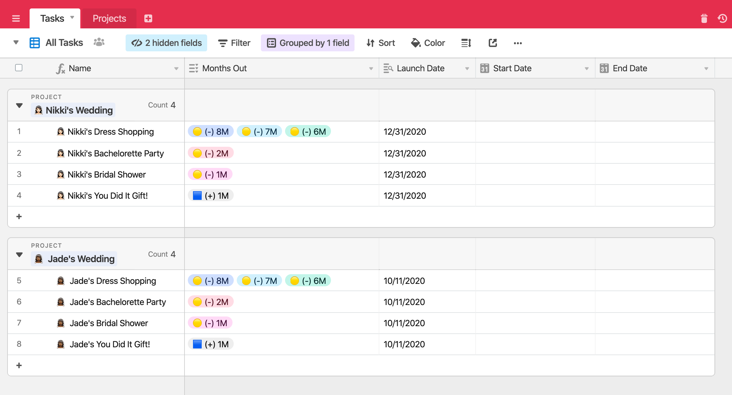

First I want to structure my table correctly, so that I can actually calculate my fuzzy date. My friend’s wedding is on October 11th, so I’ll plan back from that. What I’ve done in the below example is create two tables Projects and Tasks. In the Projects table, I’ve added my friend’s wedding date as the launch date, and am looking up that date as the launch date for each of my tasks.
I also have a field in my tasks table for “Months Out,” which basically is asking how many months out a certain task is from the launch date. As you can see, some tasks can last for multiple months, (because who finds her dress on the first try, amirite?) The script will calculate the Start and End dates of each of these tasks, based on how many months out they are from the launch date. For the example, I’ve assumed each task takes a month. I’ll dial it in once I get the dates on the calendar.
Okay that’s it. What do y’all think? How would you make this more useful? Script below, example base here.
