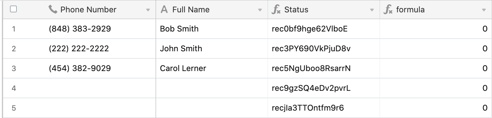

Hi everyone - I’m a total beginner to Node js but it’s very frustrating, that after hours of searching on Airtable Docs as well as through the community, I can’t seem to find the answer to one of the most basic things a user would want to do with a database.
In short - I’m trying to do a lookup. Given a “phone number” of “(454) 382-9029”, I want to return the “Full Name” of “Carol Lerner”. I want Airtable to access the right record and the code to print the “Full Name”.
In Excel this takes 2 seconds to do. I’m at a loss why this has been so difficult to find code for on Airtable Docs or Community on Node js. I know that I’m a beginner. I’m not sure why it’s so difficult to see how to do something like this. My code won’t really be of much help here as I keep getting errors when I try to run it.

Okay, great point @Bill.French. Here’s the code.
var carolNumber = "(454) 382-9029"
base('Table1').select(
      maxRecords: 3,
      view: 'Grid view'
  ).firstPage(function page(err, records)
      if (err) { console.error(err); return;  }
      records.forEach(function(record) {
          if(record.get('Phone Number') = carolNumber)
          console.log('Lookup is', record.get('Full Name'));
  • February 28, 2021
I was able to eventually figure this out. Here’s the code for anyone interested.
What was wrong was that I needed to use a “===” operator. I wish Airtable docs had something to show “If statements” so I could have learned this much faster.
      maxRecords: 3,
      view: 'Grid view'
          if(record.get('Phone Number') === carolNumber)
// Returns "Lookup is Carol Lerner"
