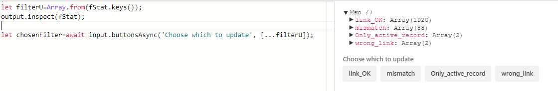

Yeah, sometimes spread operator is very useful to avoid redundant pieces of code. One-line button selector

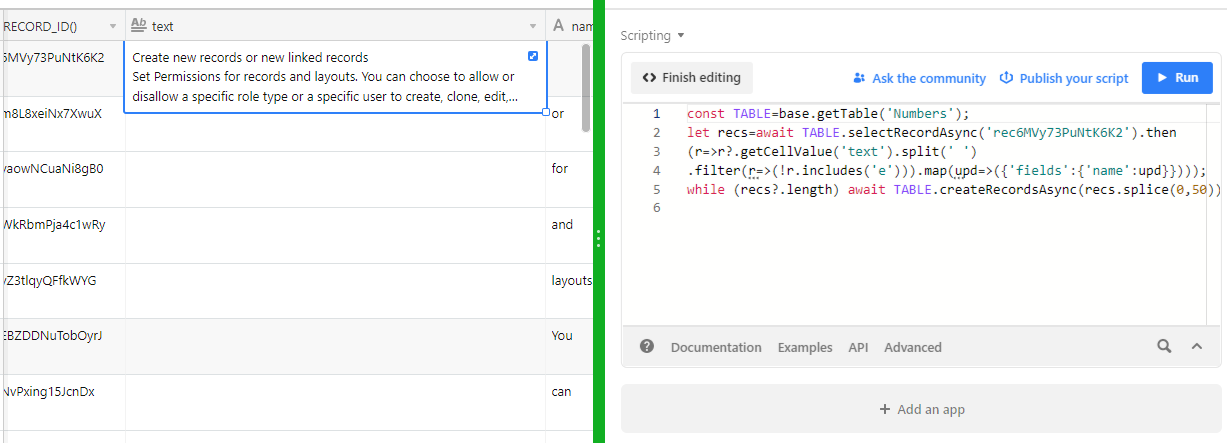

That piece of code is quite useless, takes text from record by ID and create multiple new records with it’s each word, not including letter “e”.
But it’s a good demo of basic methods and functions useful here
