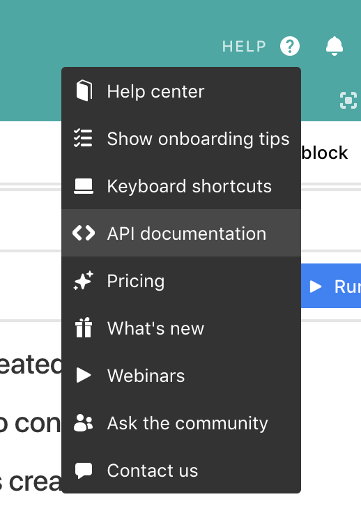

You can access the standard API with specifics for the base you want to access from the “Help” menu of the base you want to access.
