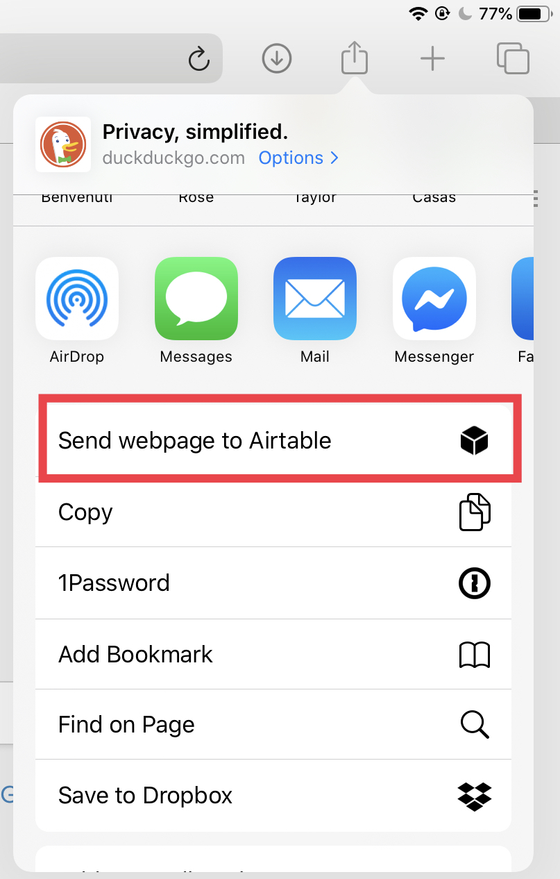

Welcome to the community, @Matt_Roberts.
Every Airtable base is a custom base, so there’s no standard share sheet extension that Airtable could offer that would work for everyone.
However, you can easily create your own custom Share Sheet extension to send data to Airtable using the iOS Shortcuts App.
This uses Airtable’s REST API, so you can actually do anything that the Airtable REST API supports (i.e. create, read, update, delete).
Below is a screenshot of an example of how this could look in the iOS share sheet, and you could create as many of these as you need for different Airtable scenarios:
There is an instructional video on how to do this here:
Hope this helps! If this answers your question, could you please mark this comment as the solution to your question? This will help other people who have a similar question. :slightly_smiling_face:

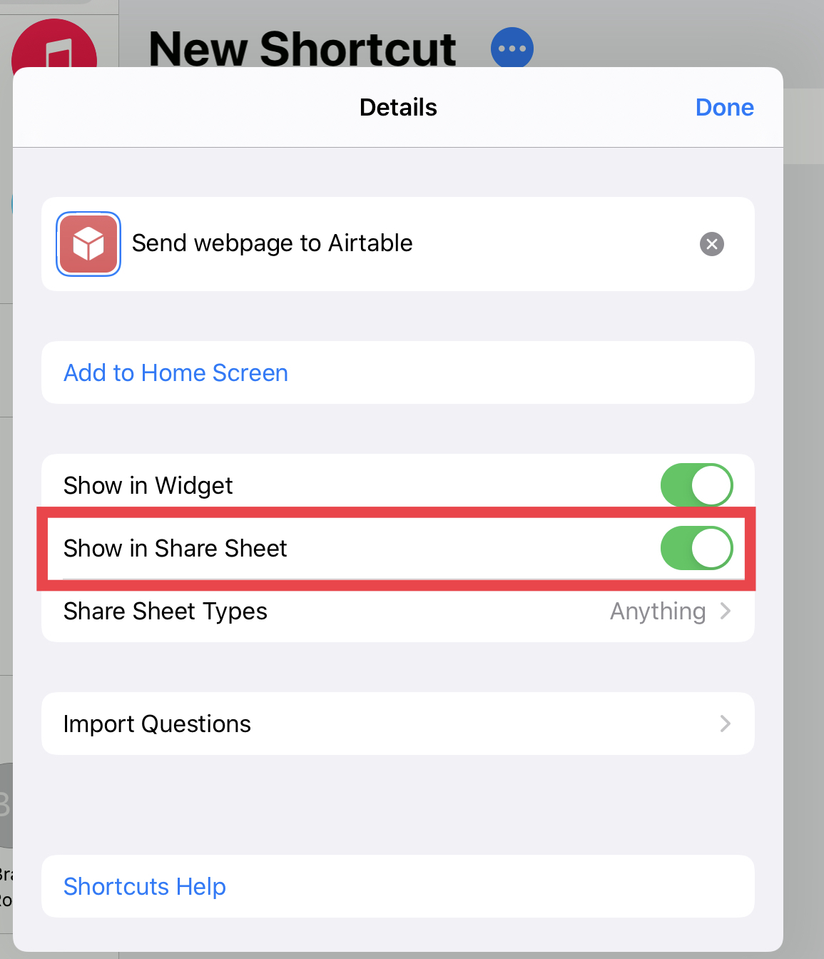

Hi @ScottWorld
Where is this screen share on a mobile device?
Is it part of a shortcut?
How to go about creating this shortcut?
Inquiring minds would like to know! :grinning:
Thank you,
Mary
Hi @ScottWorld
Thank you,
Mary

Hi @Justin_Barrett
Thank you for letting me know.
So is this part of a shortcut or how is this done? I’m trying to visualize this, since I am a visual person.
I am curious to know.
Thank you,
Mary
  • Jul 28, 2020 12:07 AM UTC
Hi @Justin_Barrett
Thank you,
Mary
Hi @M_k, when you create a shortcut on iOS, one of the options is to show the shortcut in the share sheet. See screenshot below:
