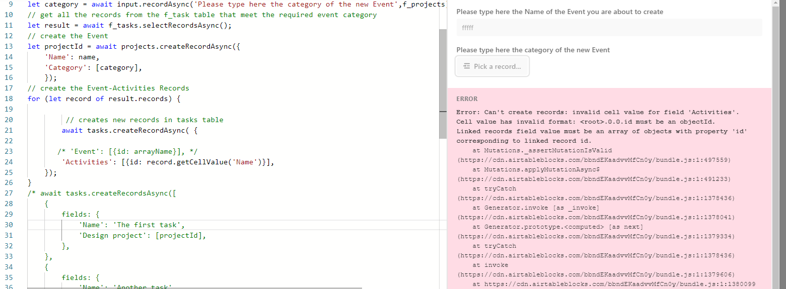

I am creating a new record and don't know how to populate the 'link' fields
Benito_Abraham
Forum|alt.badge.img+8
This is my code and I can’t populate the field ‘Activities’ which is linked to another table, the error is in line 24
11 replies
  • March 15, 2020
When writing to a linked field, use an array of record ids, not the record names.
"Activities": [{id: record.id}]

The problem that I am having right now is that I don’t know how to retrieve the records’ id of the linked table.
I added this code
// new code
let queryResultT = await projects.selectRecordsAsync();
for (let record of queryResultT.records) {
output.text(record.id);
let lastRecordID = record.id;
// new code
but here:
create the Event-Activities Records
for (let record of result.records) {
// creates new records in tasks table
await tasks.createRecordAsync( {
‘Event’ : [{id: lastRecordID;}],
/* ‘Activities’: [{id: record.getCellValue(‘Name’)}], */
I get an error that says " can not find name ‘lastRecordID’"
Thanks in advance

@Benito_Abraham Welcome to the wonderful world of variable scope in JavaScript.
You set the variable lastRecordID in the for loop. Notice the use of the let when you declare it. That means that variable exists only within the scope of the for loop. If you try to use it outside that scope, it will be undefined.
// new code
// new code
When you want to use the variable lastRecordID later on, it is undefined, because you are in a different scope.
To fix the problem, you need to declare the lastRecordID variable in a scope that is accessible to both where you want to set it and where you want to use it. (You can declare it without setting a value.) Then, just set it in your for loop.
If you’re new to JavaScript, I recommend reading up on variable scope. Understanding scope can save you a lot of headaches.

Thank you for all your help, I just wanted you guys to know that I finally made it work and in case someone may find it useful, want to share the code with you:
// pick tables from your base here
let f_tasks = base.getTable(‘ACTIVITIES (CHECKLIST)’); // activities to be used as a template
let f_projects = base.getTable(‘EVENTS CATEGORIES’); // Events to be used as a template
let projects = base.getTable(‘Events’); // new Events table
let tasks = base.getTable(‘Events - Activities’); // new activities table
// prompt the user to pick a name for our new Event
let name = await input.textAsync('Please type here the Name of the Event you are about to create ');
// prompt the user to pick a template for our new Event
let category = await input.recordAsync(‘Please type here the category of the new Event’,f_projects);
// get all the records from the f_task table that meet the required event category
let JSONCategory = JSON.stringify(category);
let categoryView = JSONCategory.substring(JSONCategory.search(‘name’)+7,JSONCategory.length-2);
let result = await f_tasks.getView(categoryView).selectRecordsAsync();
// create the Event Record
let projectId = await projects.createRecordAsync({
‘Name’: name,
‘Category’: [category],
// create the Event-Activities Records
var firstLoop = ‘Y’;
if(firstLoop == ‘Y’){
for (let recordx of queryResultT.recordIds) {
var recordt = [{id: recordx}];
firstLoop = ‘N’;
‘Event’ : recordt,
‘Activities’: [record],
output.text(‘Done!’);
