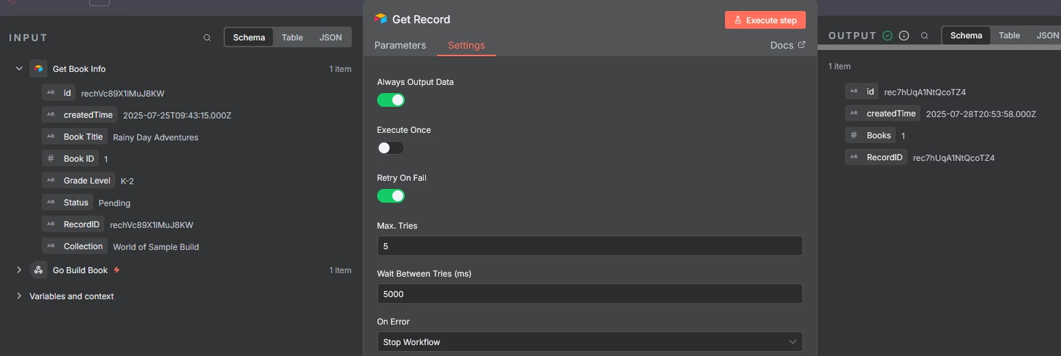

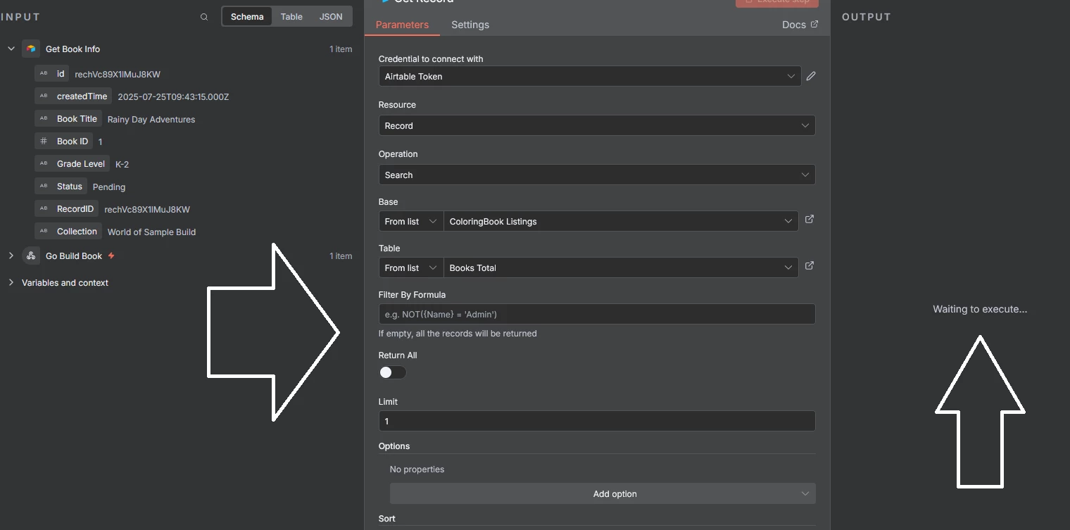

There are 2 ways a node can create an output.
  1. Processing the  Execute Workflow ( 1st image ), it should have created the OUTPUT and continued to the next node. This does not. Note the arrows.
  2. Processing it manually using Execute Step. Doing this does validate the OUTPUT, and the Airtable node does display the requested process, and displays it correctly ( 2nd image )

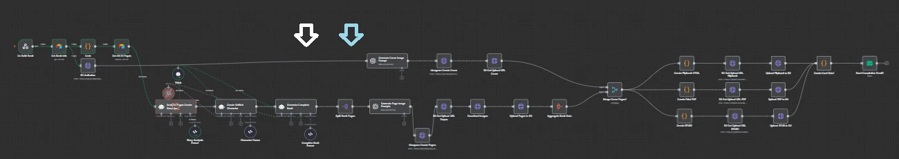

Hey ​@SSB-Buils,
Would you please send a screenshot of the full workflow? i.e. not the specific node, but the full workflow?
  • July 30, 2025
I removed them - This is how it was set up
  1. White arrow - image from above
  2. Then an UPDATE node in blue
