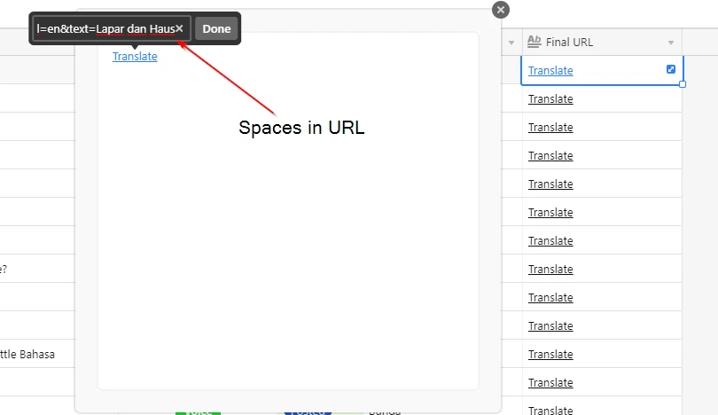

I have been trying to add a rich text field and use Markdown Language to create a “Pretty” URL Link
Clickme
I’ve come to realize, after googling that, it will only work using the API. So, I used Integromat to populate a Rich text field with Clickme in it.
The URL is made up fro a concatenated formula ad some of the URL’s have spaces i.e https://www.anywebsite.com/some%20spaces
This is not being created correctly when the URL has a space like this. Is there anything I can do?

Hi Bill,
Yes. I have the Hypertext created but the URL link behind it has spaces in so the link fails but also when dropped onto the report, it shows as the Markdown txt

Still not working for me. I have recorded a Loom as I am probably doing a bad job of explaining myself.
Hope this helps

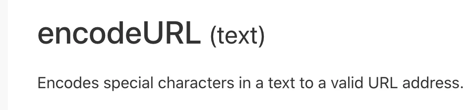

You’re doing a find job of explaining the issue.
Here’s what’s happening (I thinkl)… when Integromat reads the content from Airtable it is unencoding it, thus eliminating all the great work you did in Airtable to properly encode the data.
When I mentioned that the URL needed encoding, the implication was that it would either occur when building fields that contained the URL in Airtable, or when any other external process generated such URLs; in this case, Integromat.
Integromat supports functions and formulas much like Airtable - indeed, the string functions include encodeURL and this would likely be the place to perform the encoding before updating the data back into your long text field in Airtable.
