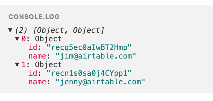

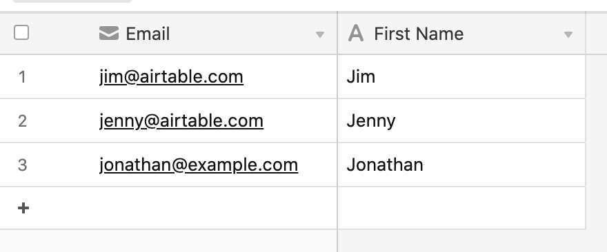

H @Lisa_Hagan - what you get back is an array of the filtered records. By default this contains the id and the name (the Airtable record ID and the primary field value:
But you can loop through this array and access any of the fields attached to each record. So if I have this:
Then I can access the first name like this:
for (let person of filteredRecords) {
    console.log(person.getCellValue('First Name'))
So, the full script is:
let table = base.getTable('People');
let query = await table.selectRecordsAsync();
let searchTerm = await input.textAsync('Enter your search term');
let filteredRecords = query.records.filter(person => {
    return person.getCellValue('Email').includes(searchTerm)
console.log(filteredRecords);

Thank you Jonathan. This makes sense.
