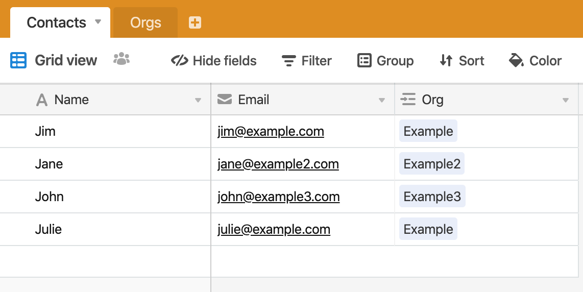

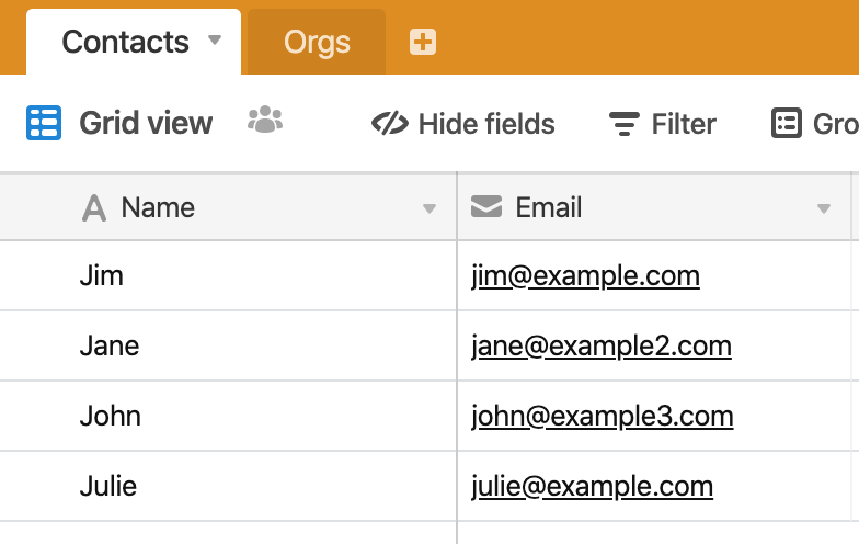

Here’s my variant: I’ve assumed there’s some data in the contact record that can be used to determine the Org.
So in this (somewhat contrived) example, the domain of the email, less the “.com” is the Org name (lower-cased).
let contacts = base.getTable("Contacts");
let orgs = base.getTable("Orgs");
let contactsQuery = await contacts.selectRecordsAsync();
let orgsQuery = await orgs.selectRecordsAsync();
for (let contact of contactsQuery.records) {
    for (let org of orgsQuery.records) {
        let email = contact.getCellValue("Email");
        email = email.split('@')[1];
        email = email.split('.')[0];
        let orgName = org.getCellValue("Name").toLowerCase();
        if (email == orgName) {
            await contacts.updateRecordAsync(contact, {
                "Org": [{id: org.id}]
It loops through every contact and for each contact, loops through the orgs until it finds a match.

Great idea! To avoid the nested loop, you could also create a mapping first based on an email domain field:
let contacts = base.getTable('Contacts');
let orgs = base.getTable('Orgs');
// You could also use an ES6 Map here:
// https://developer.mozilla.org/en-US/docs/Web/JavaScript/Reference/Global_Objects/Map
let orgIdByEmailDomain = {};
// Map each email domain to an org record id
    let emailDomain = org.getCellValue('Email domain');
    if (emailDomain) {
        orgIdByEmailDomain[emailDomain] = org.id;
    // Look up this contact's email domain
    let email = contact.getCellValue('Email');
    if (!email) {
        continue;
    let emailDomain = email.split('@')[1];
    let orgId = orgIdByEmailDomain[emailDomain];
    // If our mapping contains this email domain,
    // link this contact to the corresponding org
    if (orgId) {
            Org: [{id: orgId}]
