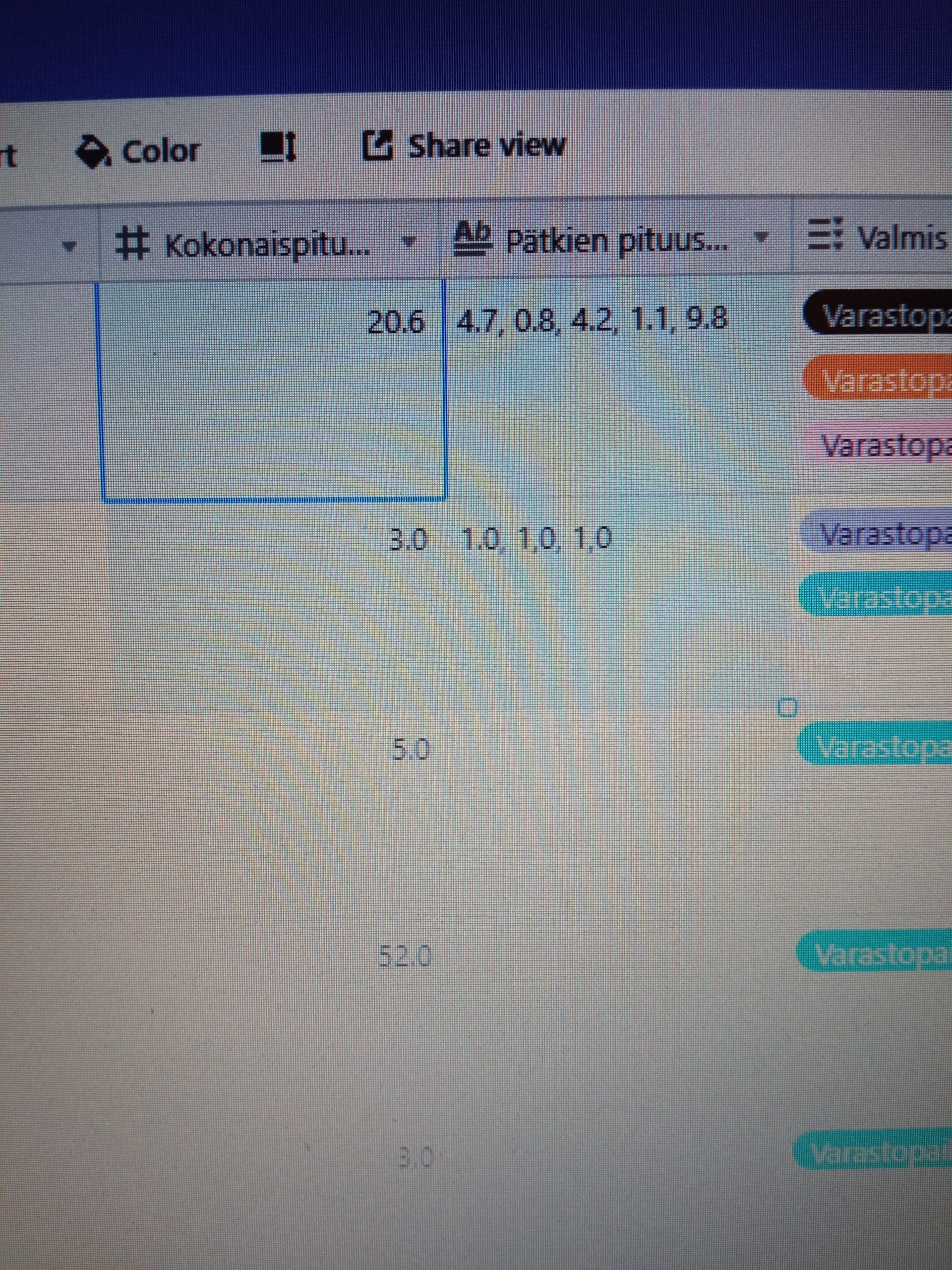

These numbers are typed manually. Now they are in a text field as you can see in the image, on the left total length and on the right the snippets. I’d like them to add up to the full length column.

Hi @Mika1,
Not sure how I got to this super old post, but it looks like a topic worth solving! Obviously getting bunch of numbers into a single field is not a good idea, but if that is the input data - it can be summarized with script below.
I assumed that white space or comma is used to separate numbers.
// Change this name to use a different table
let table = base.getTable("Summary");
// Prompt the user to pick a record
// If this script is run from a button field, this will use the button's record instead.
let record = await input.recordAsync('Select a record to use', table);
if(record){
    const textValues = record.getCellValue("oluet lasketaan")
    // here we are spliting the text using comma "," and whitespace "\s" as separator
    // you can but any other separators in the [] regex bracket
    const arrayWithTextValues = textValues.split(/[,\s]+/)
    // converting text to number and summing up all values, 0 - is initial value
    const sum = arrayWithTextValues.reduce((a,b) => Number(a) + Number(b),0)
    //updating number field
    table.updateRecordAsync(record, {"kokonaiskulutus": sum})
I hope that helps :winking_face:
