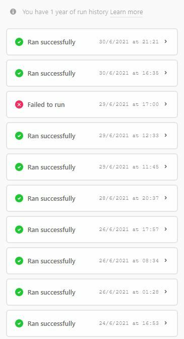

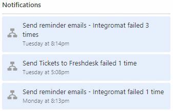

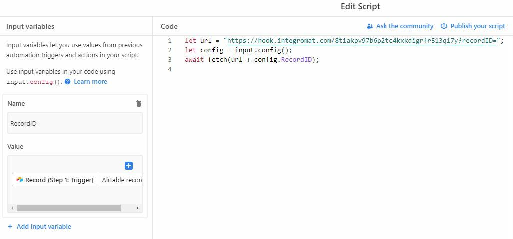

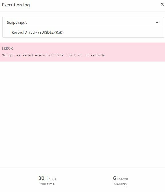

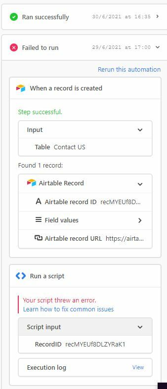

My very simple script (in an automation) to trigger a webhook containing record ID is failing intermittently. I do not know the cause. The error is “Script exceeded execution time limit of 30 seconds”.
Such a simple script shouldn’t ideally throw an error. Can anyone suggest a way forward?

In Integromat, go into your scenario settings and enable “auto commit”. That will send the webhook response back to Airtable immediately, instead of waiting for your entire scenario to finish executing before sending the webhook response.

You could also try removing the await keyword from your script, as long as you don’t have further actions that need you to await.

You leaving an await on that last line is an example of making your own luck, though. Get rid of that, like Kuovonne already pointed out and was previously implied ; it just does not make sense to write that syntax in that context, despite no errors being thrown at you. In fact, the issue might be way more convoluted than you’d suspect those three lines of code could cause, on their own.
