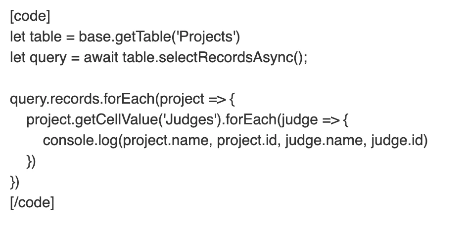

OK, I can see the problem - you’re doing forEach on the table, but you need to query the table first (which you did in the first version). This works for me:
let table = base.getTable('Projects')
let query = await table.selectRecordsAsync();
query.records.forEach(project => {
    project.getCellValue('Judges').forEach(judge => {
        console.log(project.name, project.id, judge.name, judge.id)
