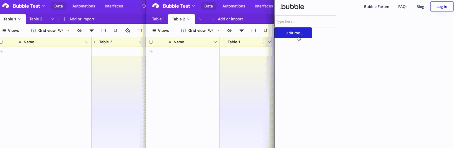

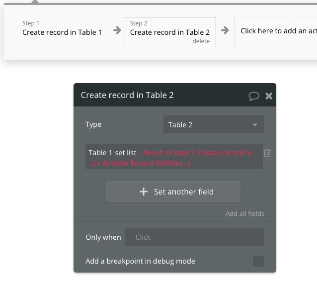

Try this:
Bubble flags it as an error, but when I previewed and ran it it worked fine:
  • June 10, 2024
Try this:
Yes this works! Very annoying that Bubble flagged that.
