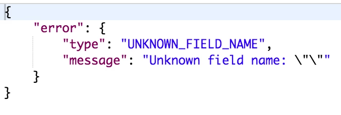

Here’s what I’m getting when I try to use the sort parameter. Without the parameter everything is returned correctly, though out of order.
Pretty strange…It seems that your array of sort objects is perhaps malformed in your request url.
A work around to this is that you do not pass the sort parameter and create a view on your base that has the data ordered by date
You can then pass in the the above newly created view name as the value to the “view” parameter in the request
The data returned should be in the same order as they appear in that view.
