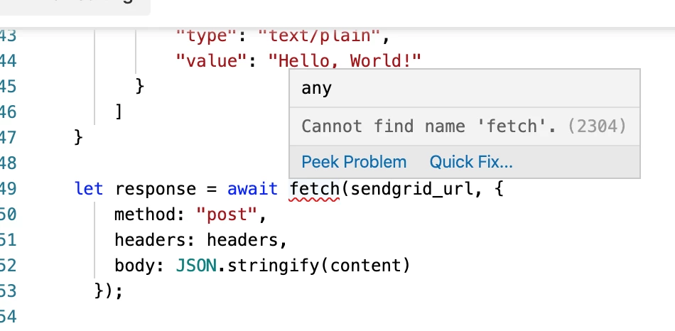

Hi - not sure if I’m doing something odd here, but I cannot get fetch to work in the Scripting block. Getting this:
cannot find name ‘fetch’
Normally, I would think this is my user error, but I have another base using the “original” pre-beta version (2 weeks ago) and fetch works OK in this.
Any thoughts @Kasra ?

Ah good catch! It will actually work if you run the script, the editor just doesn’t know about fetch right now, which is why it’s complaining. We’ll get this fixed, thanks.

Thanks @Kasra - I don’t think the script would work for me (I certainly tried it) but will try again.

Hi @Kasra - just tried this again and can’t get fetch to work. This is my script:

This script works correctly on the pre-beta release base, but doesn’t work on the current beta release base. As you say, the fetch command is highlighted in the code editor, but when I run it in the current beta release, I’m also getting this as an error message:

Okay - I can replicate a facsimile outcome like this -
If I change it back to ‘Accept’ : ‘application/json’ … it works again.

@JonathanBowen It looks like SendGrid doesn’t allow client-side requests: https://sendgrid.com/docs/for-developers/sending-email/cors/#browser-only-applications
Yep, that’s what I feared.
So, one approach @JonathanBowen -
  • Stand up a Google Apps Script web service or perhaps a Heroku NodeJS app as a proxy
  • Make your block requests into your proxy service
  • Let the proxy service call into SendGrid
