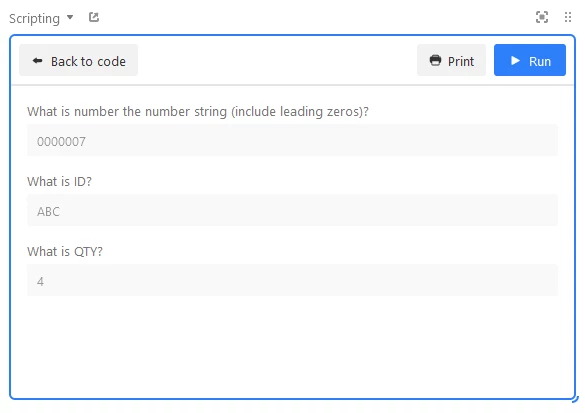

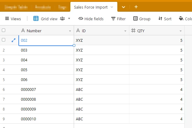

I wrote a script for you which does what you ask. I must admit, I was intrigued by the numbering and record creation order :thinking: , very peculiar… but I think the script I created should work for you - just adjust the input to work with the incoming Sales Force data (instead of the Script Extension manual input).
The above pic shows what the below Scripting Extension app and logic accomplishes;
let table = base.getTable("Sales Force Import");
let numberField = await input.textAsync('What is number the number string (include leading zeros)?');
let idField = await input.textAsync('What is ID?');
let qtyField = await input.textAsync('What is QTY?');
let recordId = await table.createRecordAsync({
    "Number": numberField,
    "ID": idField,
    "QTY": Number(qtyField)
let myData = []
for(let i = 1; i < Number(qtyField); i++) {
 myData.push(
     {fields : {
            "Number"    : String(Number(numberField)+i).padStart(numberField.length, '0'),
            "ID"        : idField,
            "QTY"       : Number(qtyField)
await table.createRecordsAsync(myData);

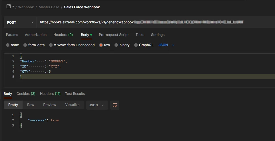

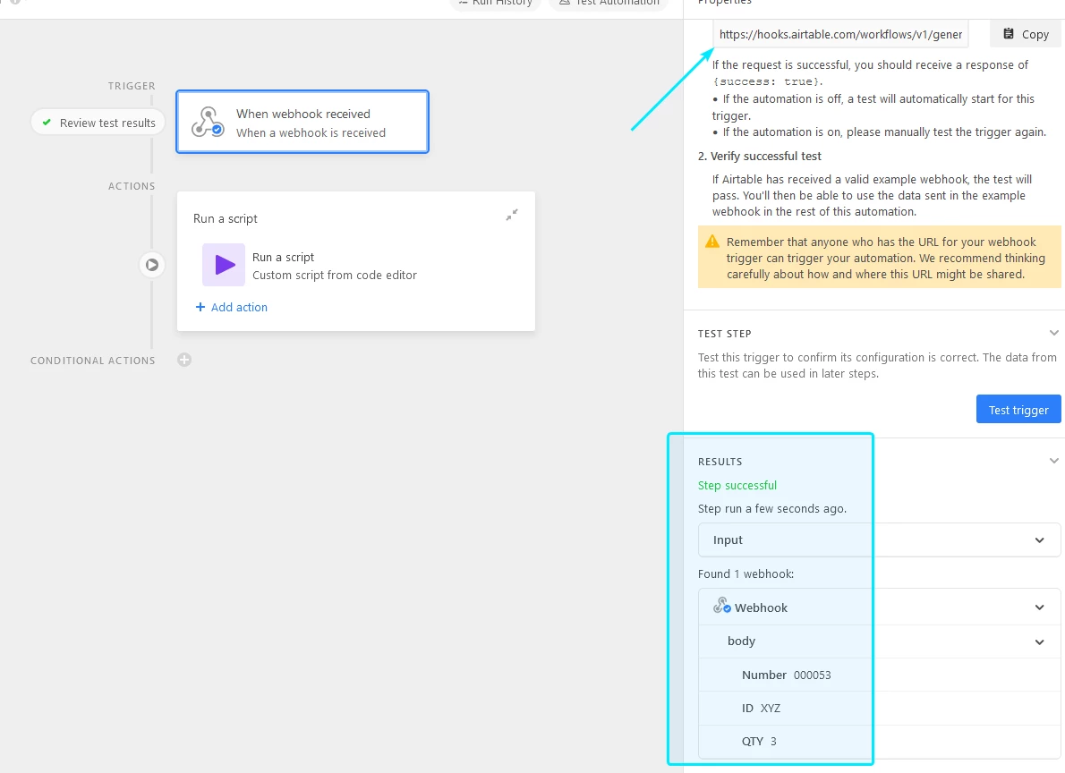

I’m personally a big fan of Webhooks for simple systems connectivity. Here we have a sample JSON sent from an application called Postman, it’s simulating Data that could arrive from Salesforce that’s posted to the Airtable Automation WebHook;
We post our sample JSON package with Postman (using a raw JSON Body), and then test the Airtable trigger;
If all goes to plan, you’ll see “Step Successful” and your data available for use in the Airtable Automation script.

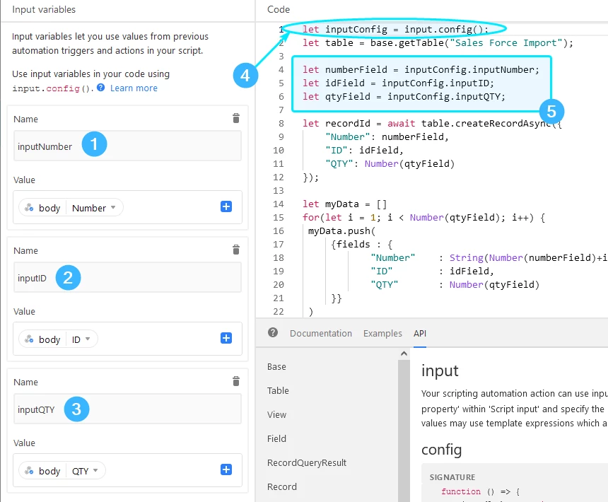

let inputConfig = input.config();
let numberField = inputConfig.inputNumber;
let idField = inputConfig.inputID;
let qtyField = inputConfig.inputQTY;
    "ID": idField,
let myData = []
 myData.push(
     {fields : {
            "ID"        : idField,
The main difference between the Scripting Extension script, and an Automation Script is as follows;

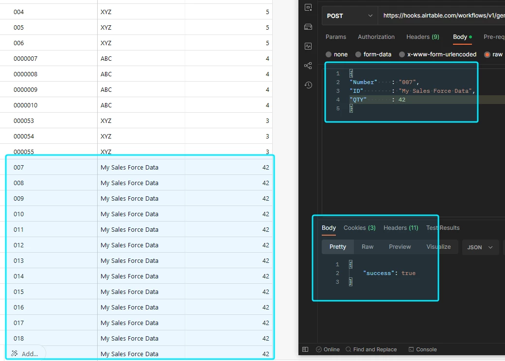

If all goes to plan - you can now test, see your test records create, and then turn on your Automation and send some more tests to it via Postman.
