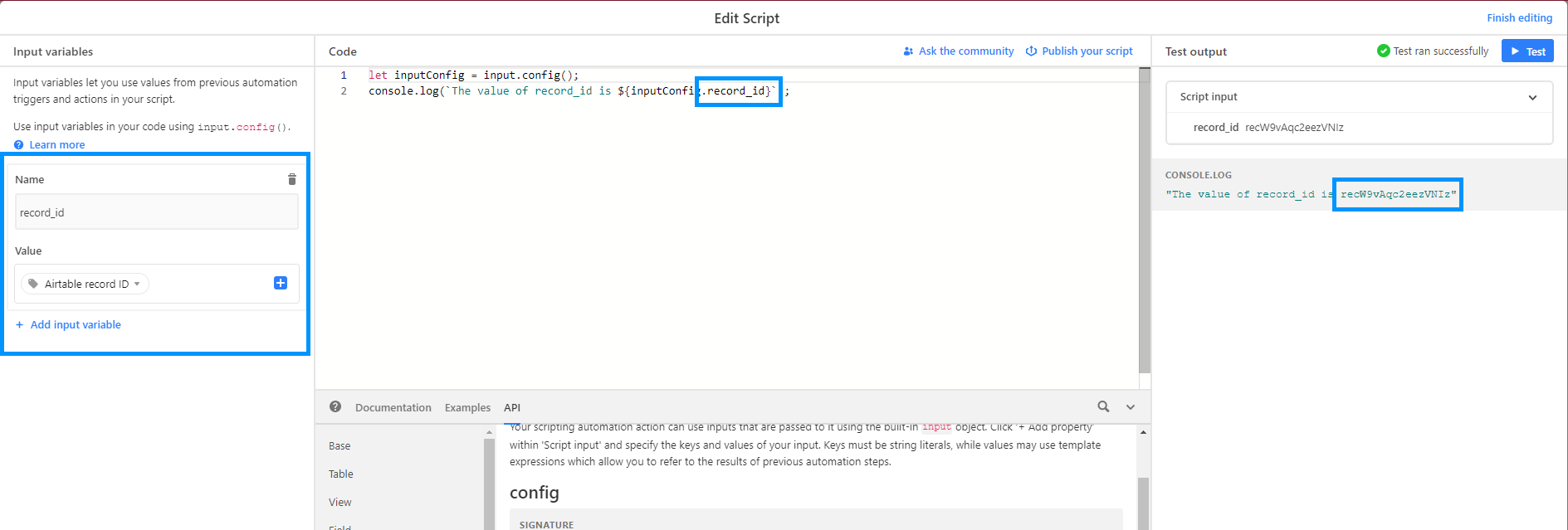

I see. You need to set the record_id as an input variable on the left hand side of the automation script editor page.
There you can add the record_id from the trigger event and call it later in your script.

Value(s) also can be retrieved directly
for example, i’m using that for kind of inter-base connection, where keeping sync is not a good solution.
let payload={...input.config()}
const options={method:'POST', body: JSON.stringify(payload),
headers:{'Content-Type': 'application/json'}}
const responce=await fetch(addr,options);
const result=(responce.ok)? await responce.json() : responce.statusText;
console.log(result)
