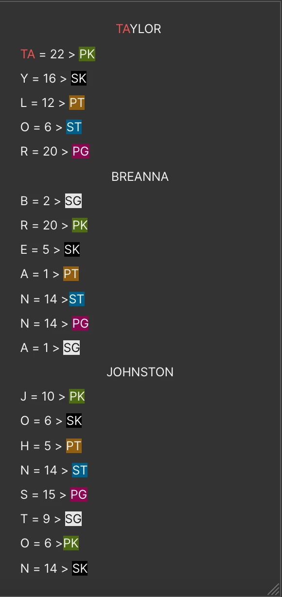

  1. Instead of adding up the total for each name, the individual values will be assigned to a specific column (6 columns) in sequential order. After the first 6 letters fill all the columns, you just start at column 1 again and loop through until every letter in the name has been assigned.
for example:
Let’s let our 6 columns be labeled as such:
column 1: PK
column 2: SK
column 3: PT
column 4: ST
column 5: PG
column 6: SG

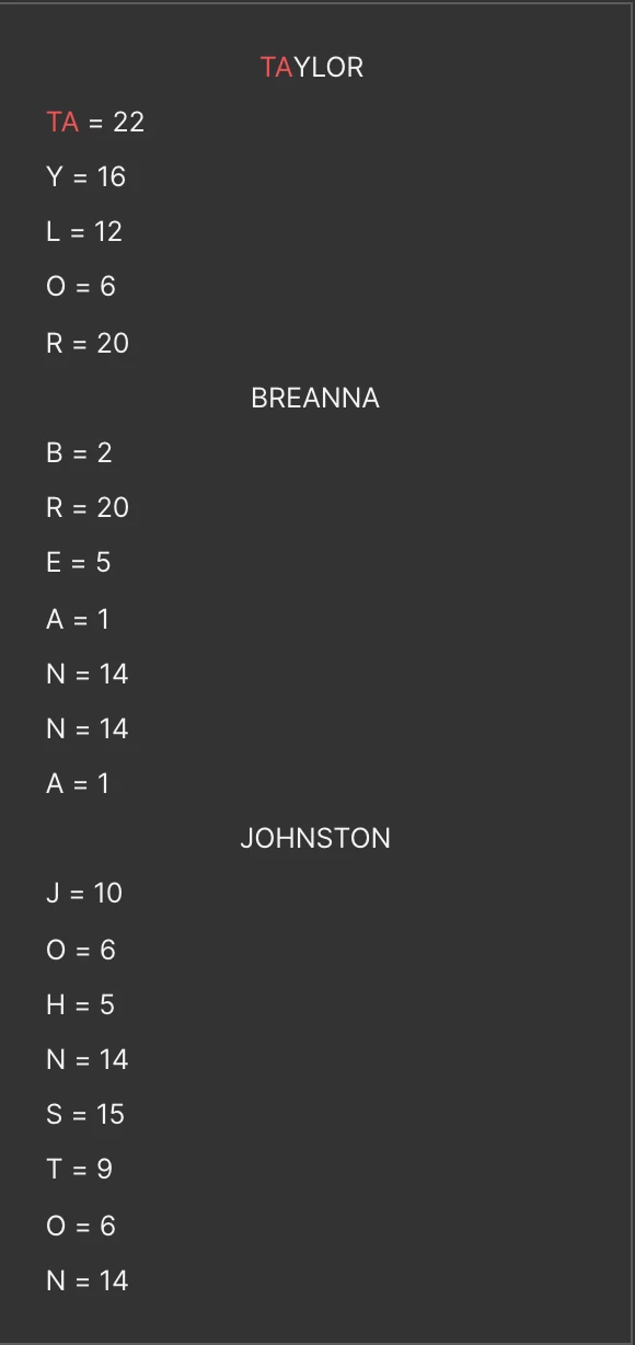

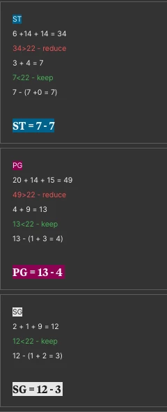

In this photo you can see the numerology value of each character and the column it would be assigned to:

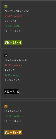

  1. This is where the values would now be added together. There is a special rule for this step, as well. The final value in each column will consist of a pair of numbers (X-X) instead of a single sum total.
    You will add all of the numbers together for an initial total. If that total is more than than 22, you will reduce the number by adding the individual components (ex: total=46 ; 46>26, so reduce: 4+6 = 10 ; 10<22, so :thumbs_up: ) < this will be the first number of the pair. The second number is the furthest reduction of the total to a single digit number (ex. 10 = 1+0 =1 ; FINAL = 10-1
here is a complete example using my name as we did in the earlier screenshots:

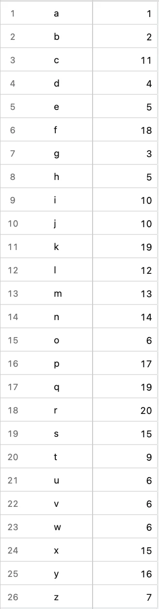

Here are more details for my request:

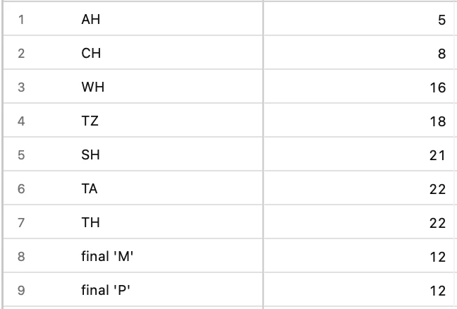

My customers submit orders through Typeform (linked to my Airtable already). First, middle, and last name are all separate questions on the form & are in separate fields in my base.
The breakdown process will need to begin with checking for specific conditions before splitting each name into individual characters. In my numerology method, there are a few letter combinations that will need to act as one character instead of as individual characters.
These are the combinations that need to be checked for (the last 2 rows of the photo refers to any name [first, middle, or last] that ends in “M” or “P”)
Whereas this is the “normal” table:
For example:
My name is Taylor Breanna Johnston. “Ta” is one of the special conditions, so my name broken down will be –
Does this make sense?

Yes it does make sense. You could start with something like this:
let twoLettersToNumbers = {
    "AH": 5,
    "CH": 8,
    "WH": 16,
    "TA": 22,
let table = base.getTable("Table1");
let queryResult = await table.selectRecordsAsync();
for (let record of queryResult.records) {
    let firstName = record.getCellValueAsString("First Name");
    let twoLetters = firstName.substr(0, 2).toUpperCase();
    console.log(`Name is ${firstName}. Two letters is ${twoLetters}`);
    if (twoLetters in twoLettersToNumbers) {
       //Do whatever with your numbers
       console.log(`Number for ${twoLetters} is ${twoLettersToNumbers[twoLetters]}`);
Now this is just a starting point and not complete but I’m in a rush. I might come back to it later if someone else doesn’t beat me to it.

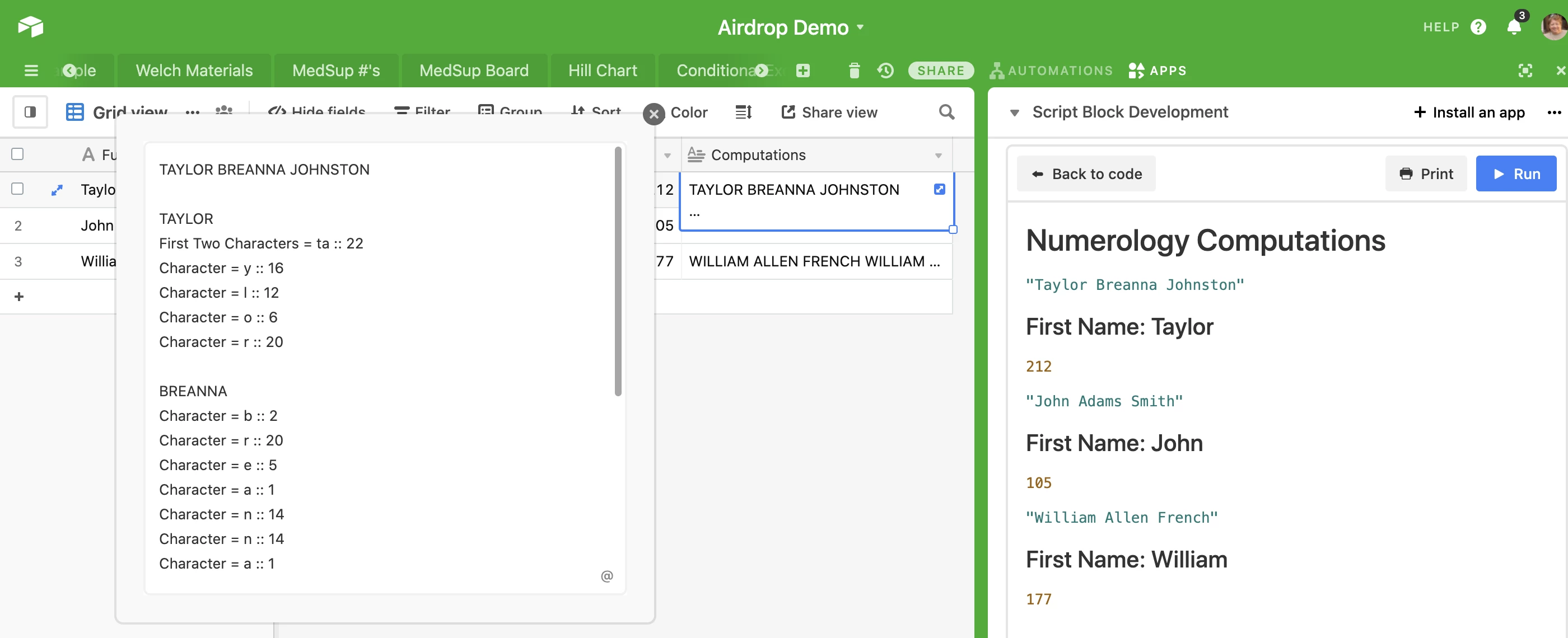

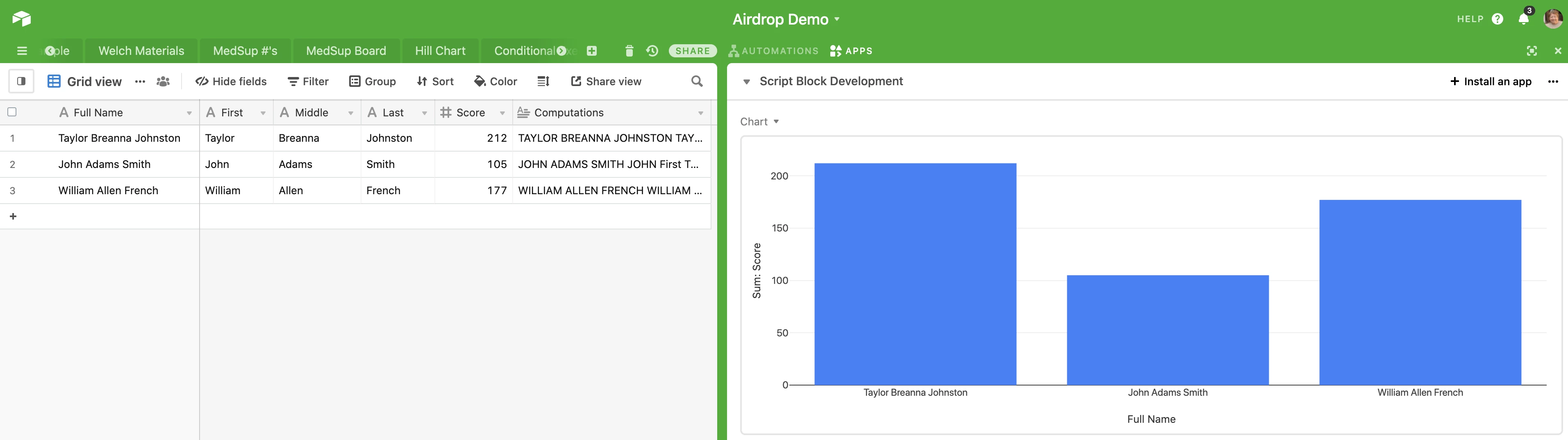

Yes, I do. However, I’m pretty slammed. I use simple examples like this to wake up in the morning. Getting my hands dirty on basic stuff is therapy; sort’a like coffee injected directly into the brain. :winking_face:
I’m also a numbers and data geek, so when I saw your plea for help, I couldn’t resist. By taking a unified approach to looking at this as purely data and analytics, Airtable makes it relatively easy to do fun stuff like this.

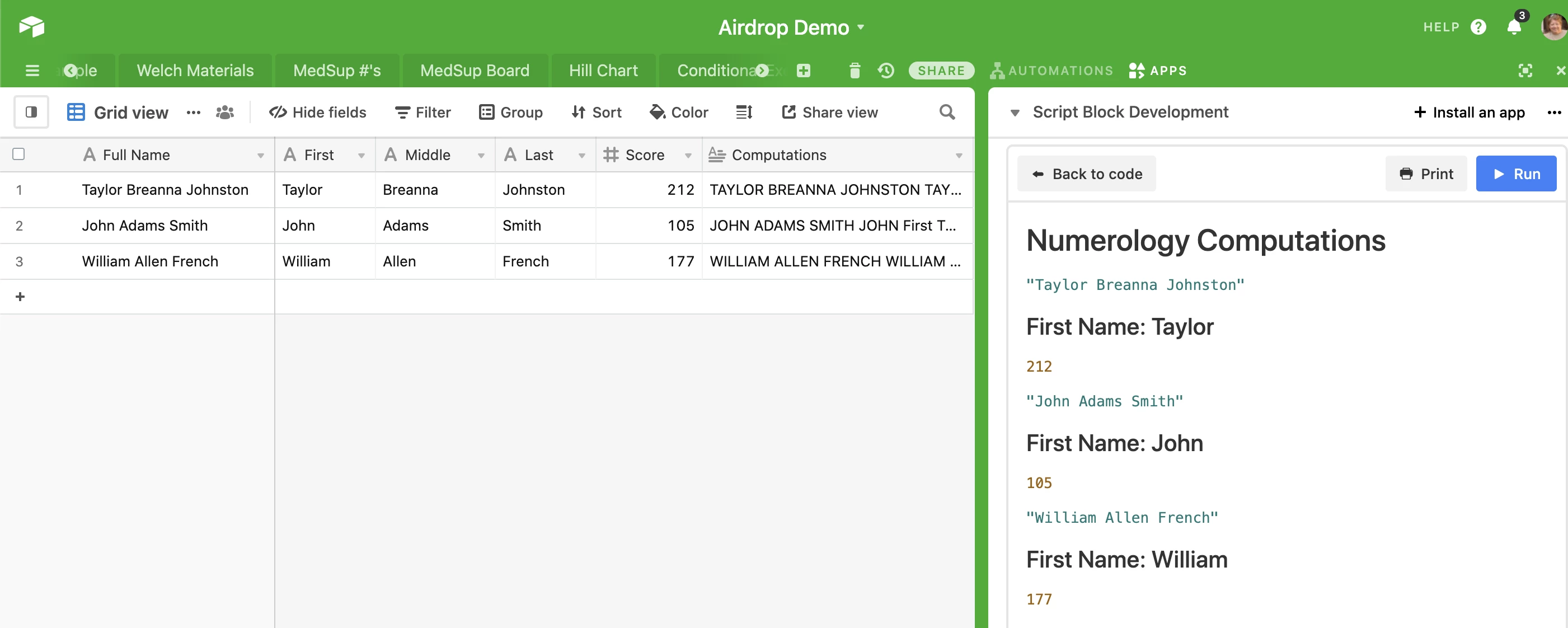

The code for this is below. Note that there are many ways to approach this solution - I chose the fast and furious approach, but if I had more time, the code would surely be a lot smaller. :winking_face:
I typically charge 99 cents a line, but in this case, it was purely unsolicited feedback so feel free to pay it forward.
Enjoy…
   ScriptBloqs - Numerology
   Copyright (c) 2021 by Global Technologies Corporation
   ALL RIGHTS RESERVED
output.markdown('# Numerology Computations');

// get the name of the table
let table = base.getTable("Numerology");
// get the records from this table
let records = await table.selectRecordsAsync();
// Update the records
let totalScore = 0;
let computations = "";
for (let record of records.records) {
    if (record.getCellValue("Full Name"))
        totalScore = 0;
        computations = "";
        output.markdown("### " + record.getCellValue("Full Name"));
        // get the names into variables
        let thisFirst  = record.getCellValueAsString("First");
        let thisMiddle = record.getCellValueAsString("Middle");
        let thisLast   = record.getCellValueAsString("Last");
        // display and log the full name
        // output.markdown("### First Name: " + thisFirst);
        computations += record.getCellValue("Full Name").toUpperCase() + "\n\n";
        // log the first name
        computations += thisFirst.toUpperCase() + "\n";
        // test first two characters of the first name
        totalScore = (oBaseClass[thisFirst.toLowerCase().substring(0, 2)]) ? totalScore + oBaseClass[thisFirst.toLowerCase().substring(0, 2)] : totalScore;
        computations += "First Two Characters = " + thisFirst.toLowerCase().substring(0, 2) + " :: " + evaluate(oBaseClass[thisFirst.toLowerCase().substring(0, 2)]) + "\n";
        // compute core class values
        for (var i = 2; i < thisFirst.length; i++)
            totalScore = (oCoreClass[thisFirst.toLowerCase()[i]]) ? totalScore + oCoreClass[thisFirst.toLowerCase()[i]] : totalScore;
            computations += "Character = " + thisFirst.toLowerCase()[i] + " :: " + evaluate(oCoreClass[thisFirst.toLowerCase()[i]]) + "\n";
        // compute core class values for middle name
        computations += "\n" + thisMiddle.toUpperCase() + "\n";
        for (var i = 0; i < thisMiddle.length; i++)
            totalScore = (oCoreClass[thisMiddle.toLowerCase()[i]]) ? totalScore + oCoreClass[thisMiddle.toLowerCase()[i]] : totalScore;
            computations += "Character = " + thisMiddle.toLowerCase()[i] + " :: " + evaluate(oCoreClass[thisMiddle.toLowerCase()[i]]) + "\n";
        // compute core class values for last name
        computations += "\n" + thisLast.toUpperCase() + "\n";
        for (var i = 0; i < thisLast.length; i++)
            totalScore = (oCoreClass[thisLast.toLowerCase()[i]]) ? totalScore + oCoreClass[thisLast.toLowerCase()[i]] : totalScore;
            computations += "Character = " + thisLast.toLowerCase()[i] + " :: " + evaluate(oCoreClass[thisLast.toLowerCase()[i]]) + "\n";
        // compute the last characters of each name
        totalScore = (oEndClass[thisFirst.toLowerCase().slice(-1)]) ? totalScore + oEndClass[thisFirst.toLowerCase().slice(-1)] : totalScore;
        computations += "Last Character = " + thisFirst.toLowerCase().slice(-1) + " :: " + evaluate(oEndClass[thisFirst.toLowerCase().slice(-1)]) + "\n";
        totalScore = (oEndClass[thisMiddle.toLowerCase().slice(-1)]) ? totalScore + oEndClass[thisMiddle.toLowerCase().slice(-1)] : totalScore;
        computations += "Last Character = " + thisMiddle.toLowerCase().slice(-1) + " :: " + evaluate(oEndClass[thisMiddle.toLowerCase().slice(-1)]) + "\n";
        totalScore = (oEndClass[thisLast.toLowerCase().slice(-1)]) ? totalScore + oEndClass[thisLast.toLowerCase().slice(-1)] : totalScore;
        computations += "Last Character = " + thisLast.toLowerCase().slice(-1) + " :: " + evaluate(oEndClass[thisLast.toLowerCase().slice(-1)]) + "\n";
        // display the combined score for this person's name
        output.markdown("Combined score: " + totalScore);
        // update the fields
        await table.updateRecordAsync(record, {
            "Score"        : totalScore,
            "Computations" : computations,
// if null, return zero
function evaluate(str)
  return((str === undefined) ? 0 : str);
Taylor_Johnston
