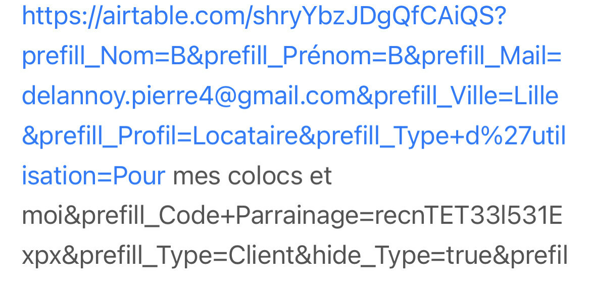

I tried the automation and realized that my issue is not linked to the length of the URL but rather to the fact that some of the fields I want to prefill (example : Type of use) have answer that are in more than one word, which breaks the formule when I want to turn it into an URL (cf picture)
I tried to add a substitute (“”, “+”) in my formula but it doesn’t seem work…
Do you have any idea on how I can process to avoid this?
I have tried to create a button and it works well but I need to put this link into an email…
Thanks a lot!

It doesn’t look like your URL is properly encoded.
You may want to use @kuovonne’s Prefilled Forms app to help you with that. This app doesn’t support hidden fields, but it doesn’t look like you’re using hidden fields:
Oh nice, it works perfectly thanks a lot!
I tried to encode it and it worked in the database but I guess I had some other issues when it came to the email!
Thanks a lot for your help !
