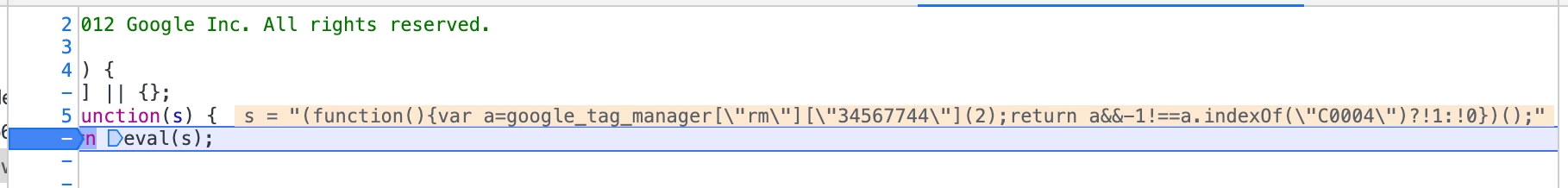

I ran into the same issue and it's pretty frustrating. From what I can tell it isn't from the SSL certificate being expired but from one of the modules being flagged for unsafe string evaluation.
