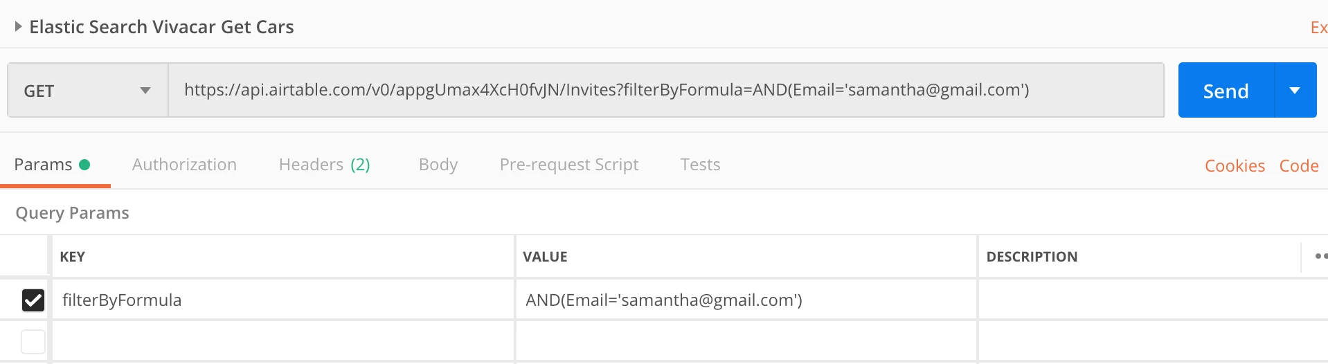

I am using a PHP library for airtable and I have a lookup method on an Email field using filterByFormula.
It works great and returns users by their email as long as these users are among the 100th first in the table.
Below that limit, they are not found.
What am I missing ?

Hi, Giovani,
Thanks for your answer but that’s not the problem
I do the following search (see in Postman)
For an email before the 100th item in the table it always work, for an email below, it returns no records even though the email exists in the table
Thanks for your assistance
Samantha
  • March 28, 2019
Hi again
I found the error and it had nothing to do with a limit after 100 rows or anything
The data I had came from several excels files I had pasted in and the one for the range after 100 rows had spaces leading in the email field …
I added a trim and everything went fine
The thing is that leading spaces are not visible in the Airtable UI :winking_face: it took me a while to find the issue
Anyway, it is solved, thanks again
