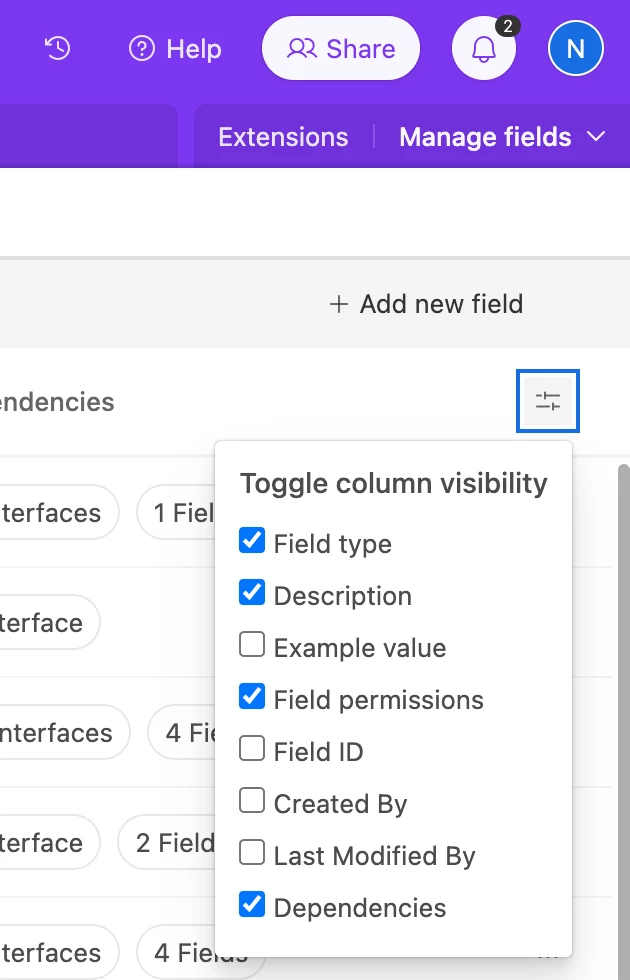

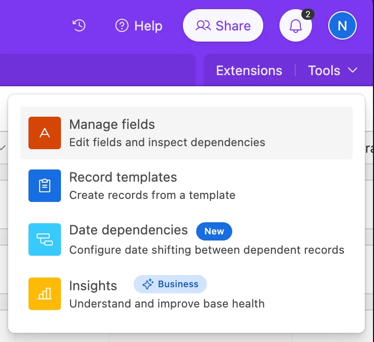

  • March 14, 2024
There is now a simple way to do it in the OOTB GUI.
In your workspace head to the right and click on the "tools" drop down, then select "manage field" and then use the filter option on the right hand side of the screen to show the Field ID (toggle visibility)
