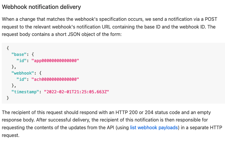

I think you're supposed to make another request for the contents after that?
Documentation here
Documentation here

Yes wow, I totally missed that part.  Now it makes sense why it's called a notification URL and not a callback URL.  Thank you.
