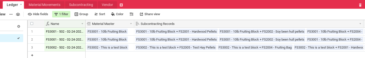

I have a ledger for tracking inventory movements.

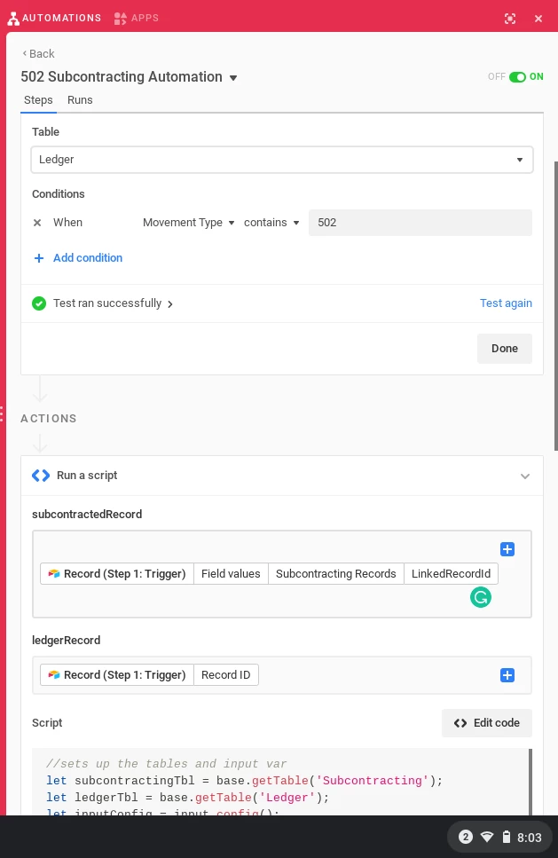

When I create a new line with a 502 movement I want to run a script. The script has an input variable which is a list of linked records from another base.
I want to read those records and get some data from them and then automatically create some new lines in my ledger base.
I am trying to pass the values from the subcontracting records lookup
The problem is when I read the subcontracting records it looks like it is reading multiples of the same record ID and when it writes to my ledger it links the incorrect material codes. Can someone help me with what I am doing wrong?
