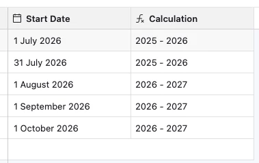

Hm, assuming your academic year is 1 Aug to 31 July, then perhaps you could try using this formula with your automation?
{Start Date},
MONTH({Start Date}) >= 8,
YEAR({Start Date}) & " - " & (YEAR({Start Date}) + 1),
(YEAR({Start Date}) - 1) & " - " & YEAR({Start Date})

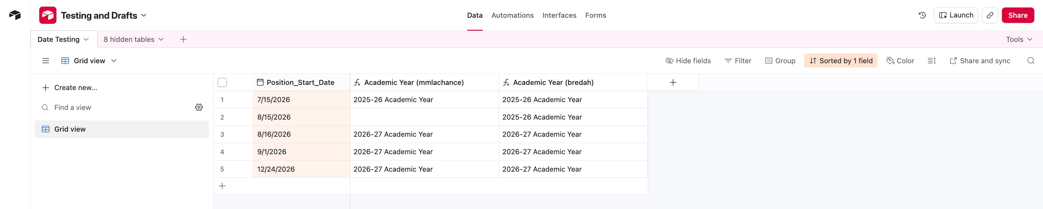

Below is the formula we currently use in the automation.
  OR(
    MONTH({Position_Start_Date}) > 8,
    AND(
      MONTH({Position_Start_Date}) = 8,
      DAY({Position_Start_Date}) > 15
  YEAR({Position_Start_Date}) & '-' & RIGHT((YEAR({Position_Start_Date}) + 1)&'', 2) & ' Academic Year',
    MONTH({Position_Start_Date}) > 7,
    YEAR({Position_Start_Date}) - 1 & '-' & RIGHT(YEAR({Position_Start_Date})&'', 2) & ' Academic Year'

  • Oct 15, 2026 8:33 PM UTC
Hey ​@mmlachance, thanks for sharing the formula! I tested it using a few different start dates, and the formula itself does appear to be handling September correctly. For example, 9/1/2026 returns 2026-27 Academic Year as expected.
I also noticed one other thing in the current logic: August 1–15 will return a blank value. Right now, the formula is doing this:
  • January–July = previous year/current year
  • August 1–15 = blank
  • August 16–December = current year/next year
If that blank period is intentional, then your formula should be behaving as expected! But if you want all August dates to be assigned an academic year, that section of the formula would need to be adjusted. For example, if you want August 1–15 to fall into the previous academic year, you could use this version instead:

I tested both versions side by side below. Your original formula is in Academic Year (mmlachance), and my revised version is in Academic Year (bredah):
Since your original formula is already returning the expected result for September, I’d still take a look at the automation step that writes the Academic Year value for one of the affected trainees. If you want to share a screenshot of that step, I’m happy to take another look! 😊
