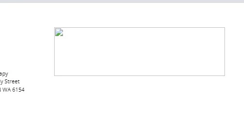

Hi - I've noticed that Page Designer has similar issues with Image URL at the moment - is this issue connected with Christoph's?
As shown in images attached, the image box in Page Designer shows a broken link instead of a logo, but even the screenshots in the Page Designer page from the Extensions collection show as broken links. Is everyone else having this issue?
Yeah it should be, from my understanding any image links with "dl" at the beginning won't work I'm afraid
As a workaround you might need to create a new table with records that hold the images you use for your Page Designer, and then link them and use lookups to display those images.  You can then reference them within your Page Designer.  Not the most elegant solution, but it works

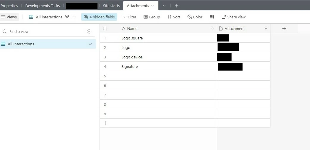

Thanks Adam... We've always had a separate table just for the image attachments for Page Designer (as pictured below). Now it sounds like I'm going to need ANOTHER table just to lookup urls of images in THIS existing table? You're right - this is a very clunky workaround, and seems crazy for an internal extension to need this for such a basic function!

Oh nah, your existing table would work fine, you'd just need to add links to your data records to it:
And in Page Designer you can see that the lookup fields would be available for selection here:
And here's a link to the base if you'd like to check it out yourself
I'm hoping that I've missed something and that there's a better way to do it too honestly
