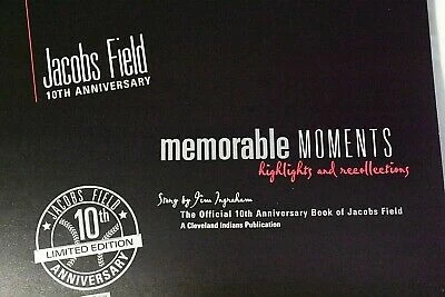

Here then is a slink to a listing done “by hand”. NO I’m not trying to sell you something!!
Jacobs Field 10th Anniversary Box Set Book & 5 DVDs Cleveland Indians |...
Jacobs Field 10th Anniversary Box Set. Could be flattened with reverse pressure. See last image - cover is depressed slightly. Limited Edition Hardbound Book.
