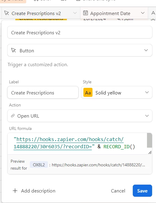

Airtable button triggering webhook Twice
  • Mar 15, 2024 4:33 PM UTC
  • 145 views
Hey guys, I have a button in my Airtable that triggers a Zap in Zapier. I'm using this code: { "https://hooks.zapier.com/hooks/catch/14888220/30r6035/?recordID=" & RECORD_ID() }, but it's triggering the Zap twice. I'm also using multiple buttons, and it's not working as expected. Can you help me troubleshoot this?
Could you provide a screenshot of your Zap history?  Bit of a long shot, but you could also try using a browser without any extensions on it; there was someone else who had a similar issue and it turned out they had a chrome extension that was triggering the webhook again for some reason.  Sadly, they never mentioned which extension it was though

  • Mar 16, 2024 11:47 AM UTC
@TheTimeSavingCo I tried using a diffrent browser, Now its working I am using a lot of extensions on chrome browser I am sure on of them is causing this (HTTP decoder chrome extension).
