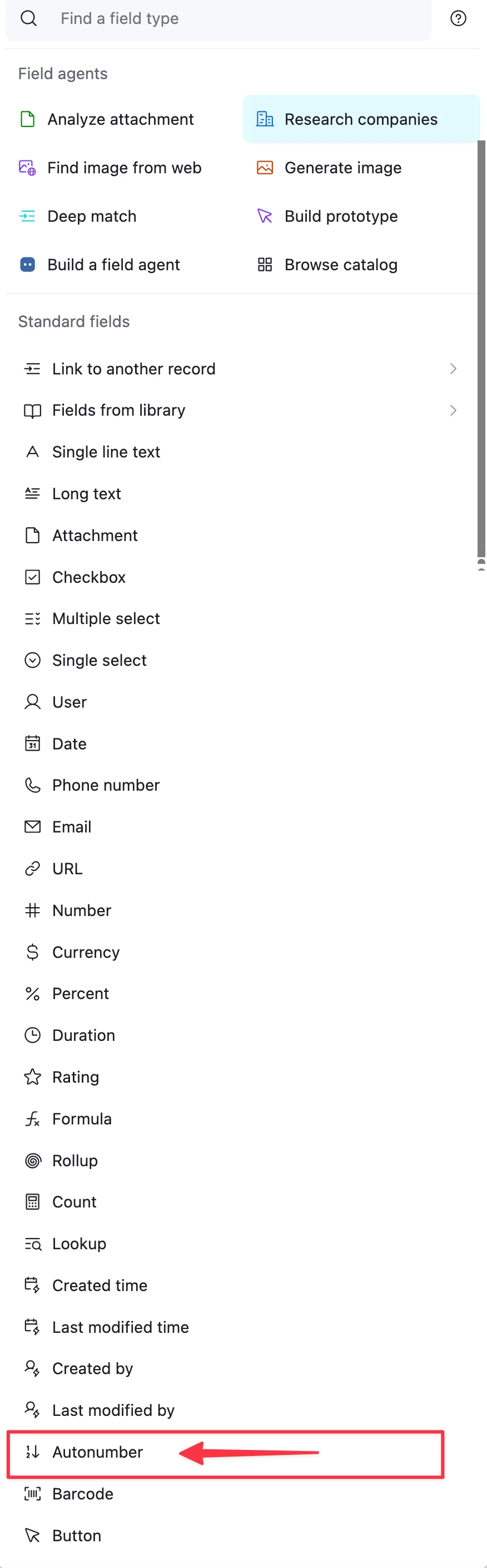

 Hello,
Airtable already has a field for this it is called “Autonumber”, create a new field in your table and scroll all the way down in the list and select “Autonumber” as the field type, you could also search for this as well.
Scroll down to the Autonumber field
