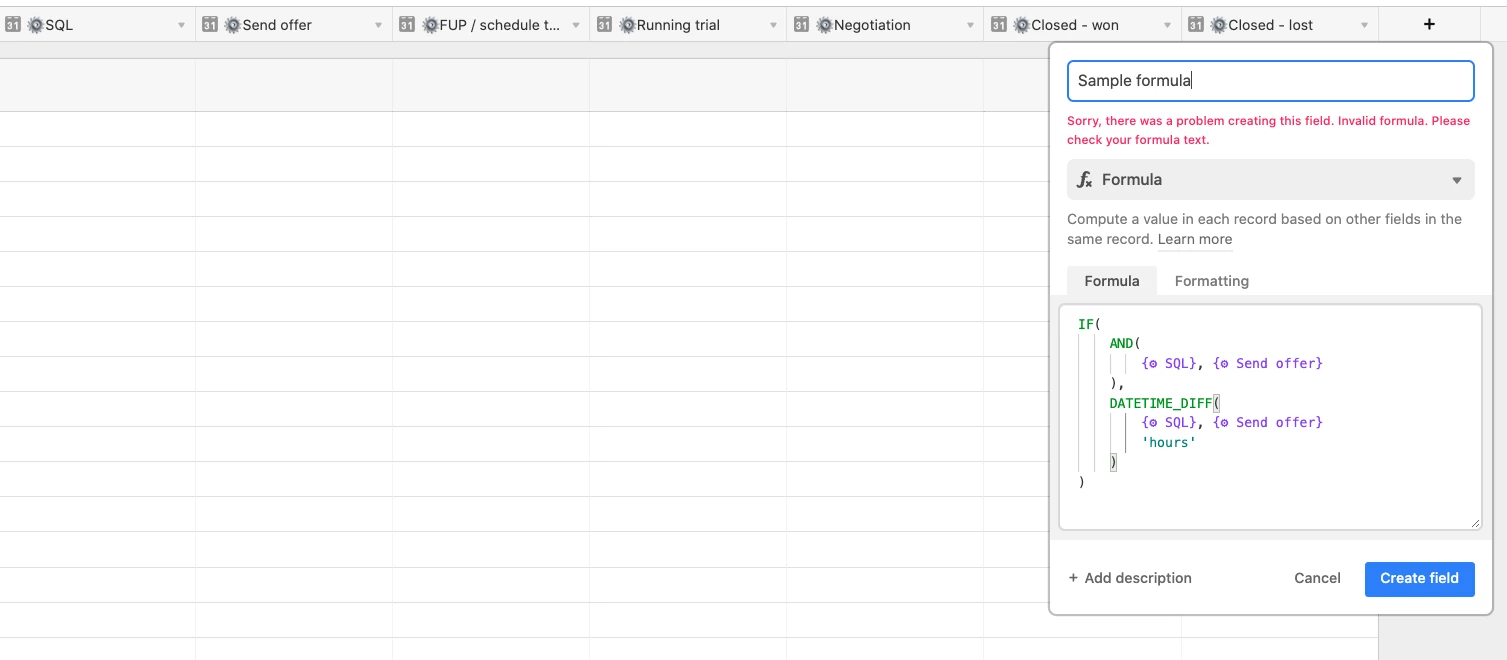

Following this airtable article, I have the automations to output when a status has been modified and outputs into a column for each step.
When attempting to create a formula, I get an error. (no ,its not the emojis, I tried without, same error). But this formula would only count from step one step to the other, and not from any to a specific step.

If the sequence doesn’t matter, one way you could accomplish this would be to create two Date fields called “Date at Status 1” and “Date at Status 4” or some such, and a Last modified time field that watched the Status field
You’d then create an automation that would trigger on record update, and would watch the Status field
This automation would have two conditional actions:
  1. Conditional 1 would be if the Status value is 1, and its action would be to paste the date value in Last modified time into the Date at Status 1 field
  2. Conditional 2 would be if the Status value is 4, and its action would be to paste the date value in Last modified time into the Date at Status 4 field
You would now have the information of when the record was at Status 1 and when it was at Status 2, and you could then use a DATETIME_DIFF() to get the number of days
The suggestion above should broadly work for this as well, just need to change out some of the conditonals, fields etc

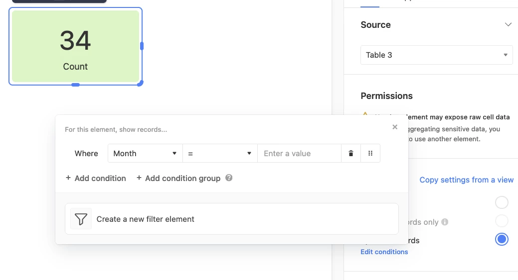

As for the first point, the Number in the interface designer allows me to show the total amount of records, and there are some filtering options. How would I get it to only show me the records that are relevant in that month?
I.e I may have 300 records, but only 22 this month. Id like to show 22, not 300.

Hmm, how do you determine what records are relevant in that month? If it’s by, say, whether the record was created in that month, you could create a Created time field and make it filter based off of that? Assuming 22 records were created so far in the current month, the number element would then show 22
