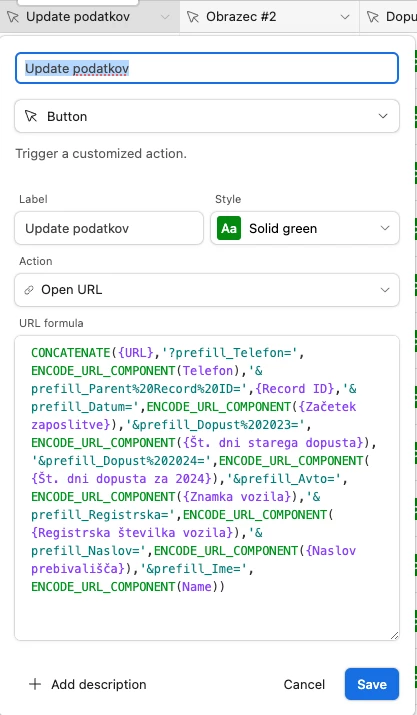

I created a base for employees in our company with the table where are all information about every employee. I also created a form to update those information if necessary. I prefill all the fields and create a button field so that i can quickly open the form. But somehow that button doesn't work with some of the employee. they were added after I created this button. I attached some photos for you so that you can see what I'm talking about.
Does anyone know what is the problem here?
If I were you I'd double check that all the fields required for the URL generation are filled in.  If they are, I'd then start deleting prefills to try to identify the specific field that's causing the issue

Buttons dim in Airtable when the URL isn’t a valid URL.
If you want to create a valid URL for prefilling forms in Airtable, I would highly recommend using @kuovonne’s Prefilled Forms Extension, which will help you create the exact formula that you will need to prefill your form.
